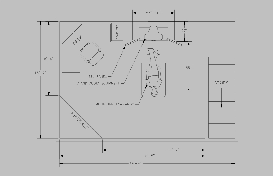

I wanted to get your opinions on my ESL project before I start to gather the parts. I'm planning on building a pair of panels 18" x 42" with perforated steel stators. These won't be full-range, but electronically crossed over to either transmission line or w-frame woofers for the bottom end.
The panels were inspired by Sheldon Stoke's panels described here.
I'll add more details on the individual parts as time allows. For now, here's a look at the listening room.

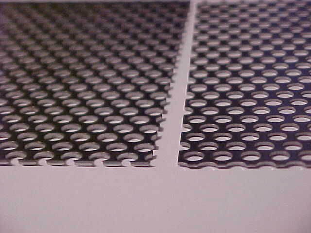

Here's a look at the perforated steel for the stators. I've got a choice of 0.036" or 0.059" thick. Both are 0.188" diameter holes on 0.250" staggered centers. I like the extra stiffness of the thicker material and think it's worth the extra US$1.07/square foot it will cost.
One side will need to be ground smooth to get rid of the burrs. I can't think of any way to round the burrs more. Too many little holes to use a countersink, but I may be able to sandblast if needed. Not sure if it's worth the trouble as the punching of the steel left what will be the diaphragm with no burrs at all.
I work for a company that just got a powder coating booth, so the stators will be powder coated. My only color choice at the moment is white. 😀 I'm thinking a walnut frame with a white sock over the ESL panels would look good and have a positive SAF.

BillH said:Here's a look at the perforated steel for the stators. I've got a choice of 0.036" or 0.059" thick. Both are 0.188" diameter holes on 0.250" staggered centers. I like the extra stiffness of the thicker material and think it's worth the extra US$1.07/square foot it will cost.
WOW... where did you get those stators???? amazing .... any sources???

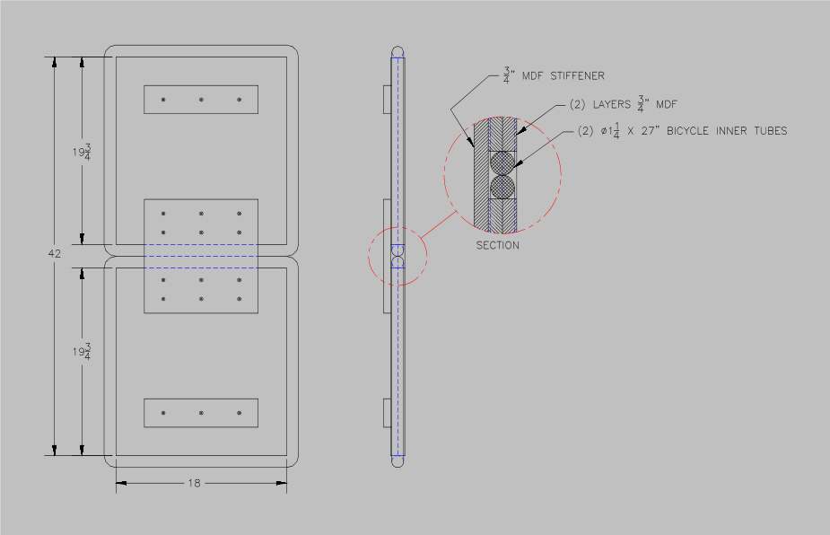

I like the DIY stretching jig done by I_Forgot, but need to figure out how to make one large enough for an 18" x 42" panel.
Maybe something like this with two inner tubes. The circumference of each half of the jig would work with a standard 26" or 27" x 1.25" diameter inner tube.
The company I work for lets me buy raw material at wholesale cost. There's quite a selection of rod, tube, and sheet in aluminum, brass, and steel to choose from. 😉

BillH said:I like the DIY stretching jig done by I_Forgot, but need to figure out how to make one large enough for an 18" x 42" panel.
I made a set of speakers with flat steel stators that were 24" x 48". I was not pleased with the result. When you have such a large area of flat steel supported only by its edges it is very unstable. Banging on the speaker frame with my hand had the steel pieces flopping back and forth.
Martin Logan solves this problem by putting a gentle curve in the steel, but that can lead to problems with keeping the diaphragm away from the stators. They seem to have it figured out, but I have never tried to do it. Unless you're willing to try to solve THAT problem, I'd recommend breaking that large panel into a few smaller drivers. It is a pain in the butt to make the electrical connections, but the speaker will be much better behaved.
Any recommendation on size? I'm not against making the panels narrower, but I'm worried that the low end would suffer. That could be fixed with a shelving circuit, though. There's a lot of narrower ESLs out there, maybe it's not that much of a problem. I've only got an 84" high ceiling so I'd like to fit the panel on top of a woofer cabinet. Woofer cabinet ~12" high.
I've seen the curved panels and it's something I could do as long as the long dimension of a panel was 36" or less. One design at The Audio Circuit used monofilament line as spacers, but I'm leaning toward keeping the panels flat for my first try.

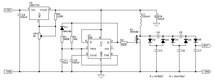

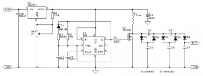

The bias supplies will be the Stokes design. A .pdf file is available here.
A description of the power supply from The Audio Circuit:
The standard household power (110 or 220) is brought to the board and stepped down, rectified and filtered to form low voltage DC (15 volts or so). This DC powers a small switching supply whose frequency is tuned to the resonant point of a secondary small rectifier transformer wired backwards. The amplitude of the driving signal is regulated and adjustable to variable output levels. Because this signal is at the resonant point of the transformer, the output is about twice the voltage level it would be if another frequency had been chosen. The output of this second transformer goes to a standard Cockroft-Walton voltage multiplier.
It's not the simplest design, but can be built with readily available parts. The voltage step up transformer is specified as a Microtran by Tamura, which I don't see listed at Jameco or Digikey, but it looks like any small 115/230V to 6.3V pc mount transformer should work with some tweaking of the resonant frequency of the bias supply.

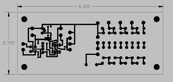

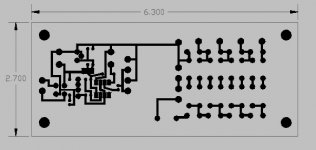

Here's a look at my pcb layout. It's almost the same as Stokes' version, with the step down transformer removed, to be replaced with an AC-AC wallwart. The translation from AutoCAD to Jpeg wasn't very good, the traces and pads look much better in AutoCAD than they do in this picture.
dstockwell writes:This is the one I planned on using, any opinions on this one.
Interesting circuit, do you have the electrical/physical specs for L1? Something like this maybe?

I am going to have to e-mail these guys and ask a few questions, I can follow a schematic if the values are shown, I do not know enough about electronics to figure out values that are not shown. Schematic
U1 - not sure if its a D,N, or M
VR1 - is that wirewound
Q1 - 200AB N-CH 500V 8 amp ??? (I do not know)
L1 - Not sure what type of inductor not enough info on schematic
Voltage rating for the capacitors that schematic does not show.
BillH said:Any recommendation on size?
If you're going for a speaker that's about 18"x42", I'd recommend breaking the long dimension into 3 or 4 separate drivers, and put a crossbar on the frame between each one, so that all four edges of each driver can be secured.
Don't worry about reduced low frequency output due to the smaller driver sizes. As long as the overall dimensions remain the same the frequency response will also.
Multiple drivers are more of a pain to assemble and wire, but they are much easier to handle, especially for the gauge of steel you will be using and the size you are going for. By using multiple small drivers, if you later decide you need more radiation area you can just make a couple more of the small drivers and add them to the speakers.

If you used 1" wide spacers and 1" wide crossbar would that bring on the dreaded
venetian blind effect? What would be the maximum seperation you could get away with?

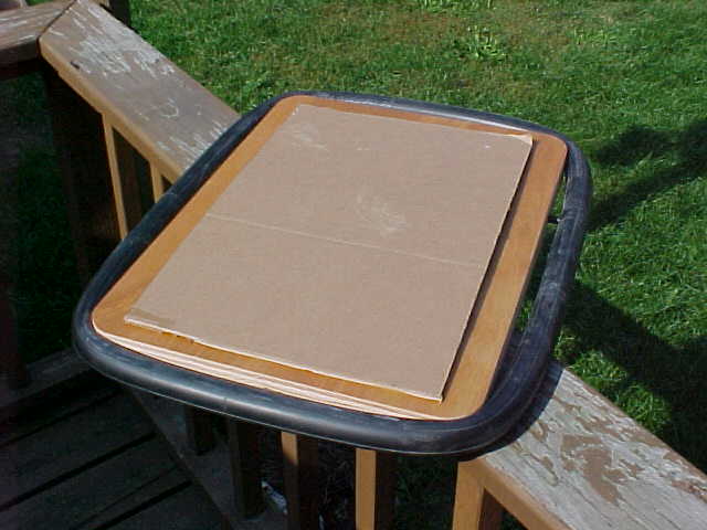

Here's a picture of the stretching jig I made today. It measures 15" x 20" x 1-1/2" thick and has a 24" inner tube. There's a 12" x 18" piece of cardboard on the top for scale.The 20" dimension should work just right with the ER Audio film which is 670mm (26-3/8") wide.
dstockwell writes:
I've spent a few hours browsing projects at Rod's site, but must have missed that one.
U1: It looks like a standard LM555.
VR1: Probably not wirewound the LM317 datasheet lists the maximum current on the adjustment pin 2 as 100 microamps. A small potentiometer should be fine.
Q1: Available here.
L1: Not much information given, but it sure does look like this.
The voltage ratings for C1 and both C8 need to be about twice the supply voltage, or more. 50 or 100 volt units are readily available and will work fine.
Lucius said:If you used 1" wide spacers and 1" wide crossbar would that bring on the dreaded
Lucius
Yes and no.
If the drivers are stacked and you listen to your speakers from 1 foot away, and like to move your head up and down in front of the speakers while you are listening, yes, the venetian blind effect will be significant. As your listening distance increases, and/or your propensity to move your head up and down decreases, the effect diminishes rapidly.
If your drivers are arrayed horizontally, as are your ears, then multiple drivers separated by some distance may produce some odd effects as you move around the room, but so will doppler effect and multipath. Generally, people who are dancing learn to live with whatever weirdness results from moving around while listening to the music. They are usually having to much fun to worry about venetian blind effects.

BillH said:Here's a picture of the stretching jig I made today. It measures 15" x 20" x 1-1/2" thick and has a 24" inner tube. There's a 12" x 18" piece of cardboard on the top for scale.The 20" dimension should work just right with the ER Audio film which is 670mm (26-3/8") wide.
Nice rounded corners! You are the first person, other than myself, that I know of to try this method of diaphragm stretching. Let me know how it works out for you.
