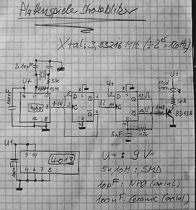

Strobe flashlight:
I decided to use a quartz-stabilized oscillator triggering a monoflop with 250µsec pulse width; this pulse drives a transistor switching a green LED with 11 candela @30mA. This is constant current rating, so the pulse current can be considerably higher without destroying the LED. I made the experience that beyond 200mA, such a LED won't increase in brightness, so 150-200 mA pulse current are a wise choice.
Of course, the flashlight could be made using a 555 timer and a driver trasistor, but this circuit will not have inherent frequency stability and it must be tuned to right frequency. And on later re-check, frequency may be not on track.
Been there, done that.
An easy way to make such a flashlight is using a 3.93216 MHz quartz and divide this frequency by 2^15(=327678). CD4060 is a CMOS chip having the oscillator and a binary divider of up to 2^14 onboard. I use a CD4013 (2x D-flop) for another division by 2 and for the monoflop.
A quartz, two cheap CMOS chips, a driver transistor and some resistors and pF caps, and an expensivish green LED, that's all. IF the oscillator oscillates at all, it does so at exactly 120Hz.
I build one as as soon as it works, i post circuit and details.

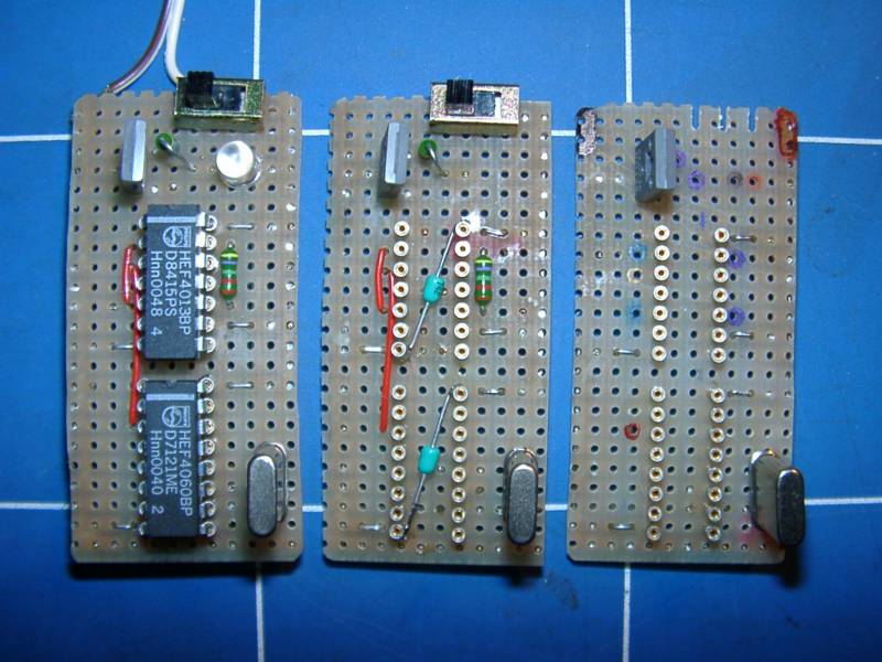

Strobe flasher works
All,
last night i got the strobe flasher work as expected. Wrong, it works better than i had expected. On right speed, the bar pattern looks like printed.
As my C-MOS cookbook did not provide an equation for the RC time constant determining the monoflop pulse width, i ended up with a smaller PW than intended but as result was so good, i left it that way. A usual monflop made from a D-flipflop has 0.6*RC PW.
My strobe flasher has exactly 120Hz flash frequency now and a duty cyle of 135µsec or 1.6% for the pulse.
I am off until Monday, then i hopefully find the time to post schematic and pixes.

All,
slowly catching up with promises.
Below you find schematic of the strobe flasher and some pixes of the testboard layout.
###edit:
/14 in the schematic should read: /2^14,
sorry for the error.
