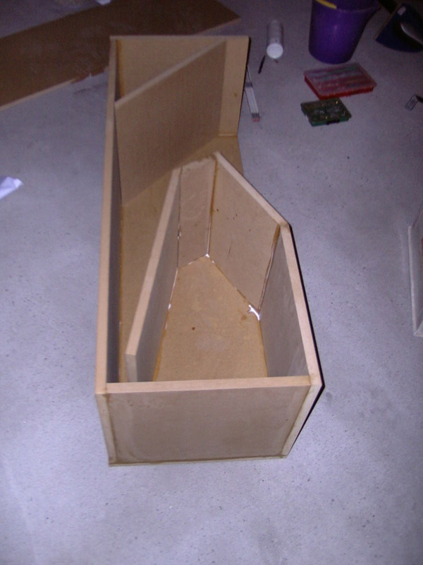

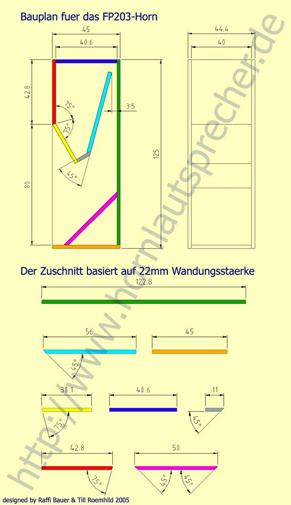

Hi @ll
I have designed a BL-Horn for the FP203.
The chamber is about 60ltr big, but I will have to reduce it a bit untill I get the sound I am looking for.
here are the datas for the Horn:
Am = 80x40 = 3200 cm²
Ah = 3.5x40 = 140 cm²
lenght = 1.1 m
chamber = < 60ltr

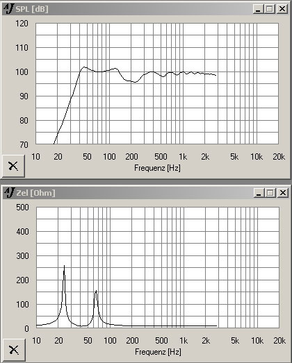

nice frequentie response!
I saved the drawings just in case

Do you have a waterfall diagram??

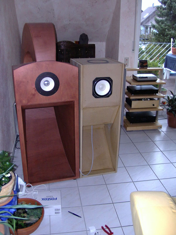

I looked up the dimensions for the original recommended BL horn for the FP203 aka BK 201. They add up to almost exactly 0.1 m³ volume. The new horn is 0.25 m³!! Size SEEMS to matter after all
Does the sound live up to your expectations so far? (I know you are still going to optimise it). The response diagram looks very promising.
Seeing the FP203s sitting next to your beautiful big horn makes me wish to see them in some adequate enclosure too. 😉

Hi Rudolf,
The horn sounds quite good but not as deep as the FX200 Horn. Ok the direct comparison is a bit unfair. The parameters from the FX200 are for my way of constructing a horn better.
Qts between 0,4 and 0,6
fs round 30 – 40Hz
- FX200 (Qts=0,45; Vas=82 ltr; fs=38 Hz)
- FP203 (Qts=0,18; Vas=81 ltr; fs=40 Hz)
But lets get first to the my room. It is too big for the FP203-Horn and I have to place it near in the middle of the room. The FP203-Horn should be placed nearer to a rear wall or even better direct to a corner. Reason is that the bass is not strong enough.
I will change the position of the FX and the FP today to see what happens. The “outline” or “contour” of the bass is really nice. You can hear all details and always have the feeling that the driver has everything under control.
The most important part for me is the midrange (voices). Here I will have to optimise the volume. The basis is good, very good. I will write more as soon as I will know how I will have to change the volume.
The details of the high frequency-area are ok but I don’t like the increase SPL of the driver. Here I will have the most work with. Right now I play with ~2,2µF and ~7Ohms parallel to the driver. Hope I will get better results and of course I will inform you as soon as I have news.
All over it looks like the construction will work.
