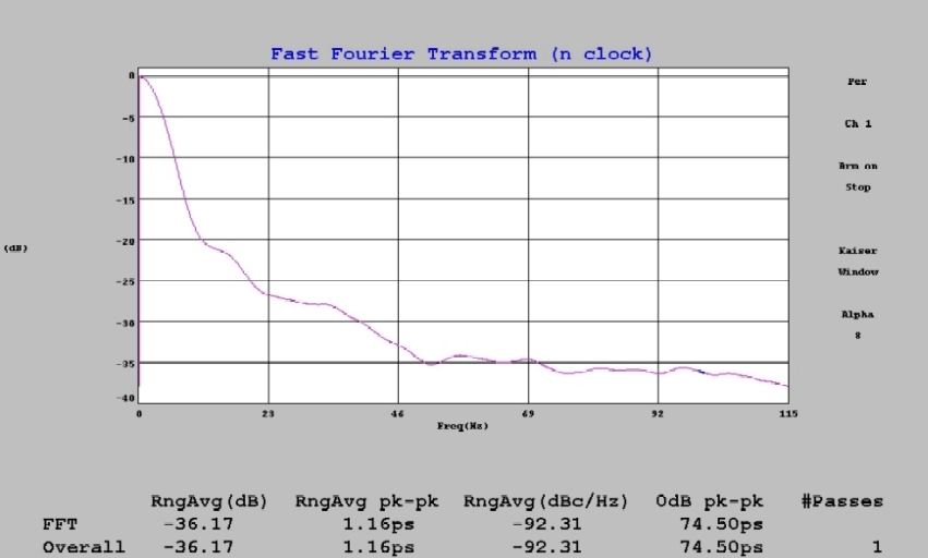

Good for aerospace does not imply good enough for audio....... Again, a meaured spec of the jitter is welcome and could convince us of the quality. All other is useless. I include one meaurement of a TentLabs XO2 oscillator module.

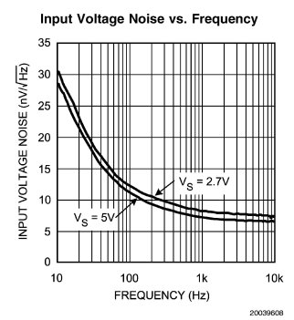

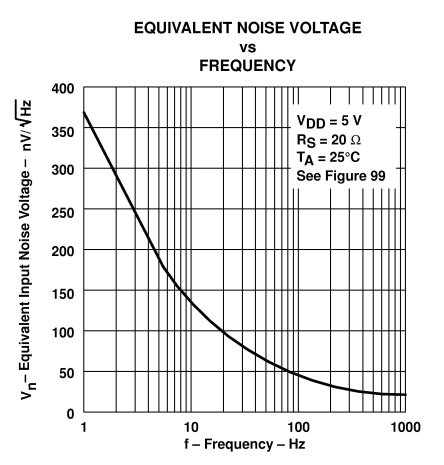

The LMV771 seems to be readily available, RR opamp, input bias current is 0.2 pA [against .6 of the tlc], input offset current is 17fA [against 100 fA of the tlc]
What regards 1/f noise, this was what I was hunting for, the LMV771 has en=12.5nV at 100 Hz, against ~300nV of the tlc271.
in for LMV is 1fA, NA for tlc.
Wanted to put up here the noise curves, still fighting with it.
The other opamps perform equally or better. What I wanted to point out that there has happened a revolution lately in the cmos opamp field, and we could profit from it..
Ciao, George

bocka said:On a first view the LMV751 is also promising
Please not in the DAC design the opamp runs at about 6V. This to ensure the VCXO can be driven easilly up to 4.5V. This value has never been measured, mostly it is between 2 and 3V so 5V could be safely chosen for this opamp. Please adapt power supply then.
Nice opamp, from spec point of view. I bet they all sound different when applied in the PLL, so go ahead and try them all !
best
Thanks for the tip!
Exactly this is what I am afraid of.. 😀
ps.: The noise curves: first the LMV771

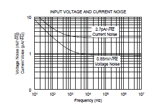

Joseph K said:and the TLC271 [but only to demonstrate the progress - at their time it was good..]
OPA847, from TI/BB:
Carlos, welcome!
I hate it, but I have to point out that I was looking for cmos opamps..
With low input bias & offset currents and unity gain stability.
This BB one, though is not applicable in the special application discussed here, is a "meraviglia' in itself. A new arrival in that wonderful family of stratosferic amplifiers, which started with comlinear. At our job here these things are having a task. That LMH6624 mentioned is also a real beauty. Though I have to say that the original CLC ones, which were maybe even older than a tlc271, had already almost the same incredible parameters.
Ciao, George
Ciao, George

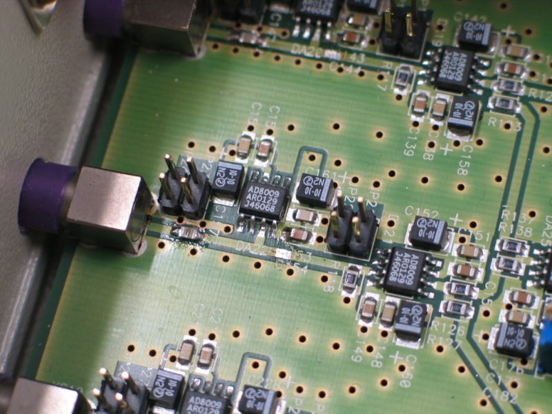

Carlos,
by the way, as I have it at hand, I just can't stand & not show this pic about the way how these things should be applied:
[This is what I would call good low impedance power supply decoupling, up into the hundreds MHz region, ai it is absolutely necessary with such a chip]
Ciao, George
Ciao, George
