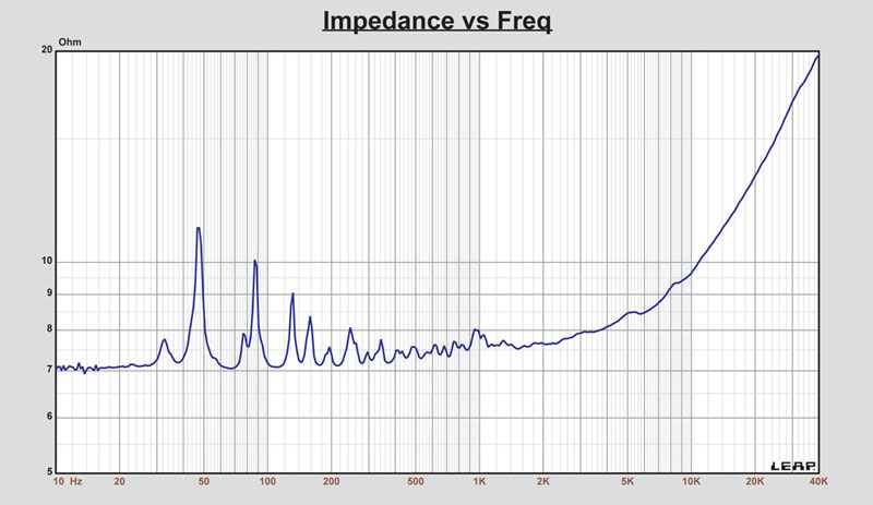

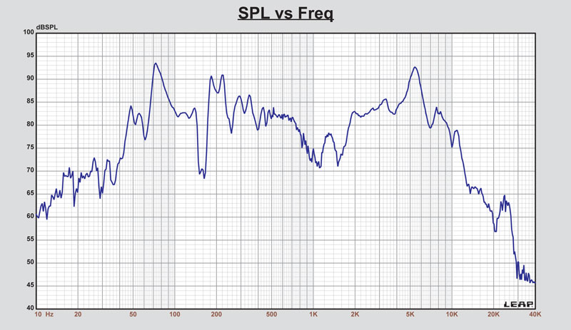

Hello everyone,
First time posting here and don't know much about this web site.
I'm D.I.Y.-ing some DML speakers, and just happened to find this thread, originally hoping to find some resources regarding DMLs myself.
Anyhow, I've bought a set of the SI-5 SoundPads and have used a sheet of 20-inch x 30-inch (50.8 cm x 76.2 cm) foam-core posterboard. I mounted the exciters at 1/3rd the height and 1/3rd the width of the posterboard, and here I attached some results of measurements.
For the SPL, there is a large peak around 5 kHz which colors the sound. I may think of passive- or actively EQ-ing it out since it doesn't make the DMLs sound very nice.
i too have a pair of these pads
haven't fully experimented with them yet. IMHO, the previous frequency response accurately describe what they sound like. i wish they didn't have a "hollow" sound, although this depends to a degree on what they are mounted with.
for my experiments, i stuck them with removable double sided tape) to a 2 x 3 ft piece of foam board (aka project boards).
i had better sound by mounting onto the inside of a large flat cardboard box (around 4 ft x 1 ft x 6") and the sound improved.
people have reported success mounting these pads on the inside of fedex boxes (check the decware board)
however, their most redeeming attribute, not shown up by the graphs, is their extremely large (i would even say lack of) sweet spot. i could be almost sideways to them with minimal off-axis fall off.
my idea for a suitable application would be for surround speakers or background music.
