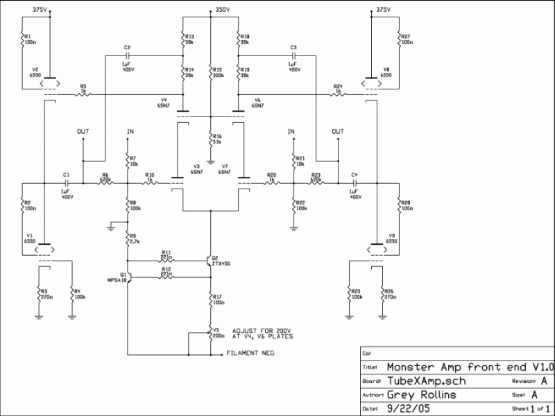

Okay, on to the circuit.
The front end is a cascoded differential. It's biased by a current source. There's a pot, V5, that is to be used to fine-tune the bias. It's the only adjustment in the whole circuit and it's really very simple: Turn V5 until the plates of V4 and V6 are at 200Vdc. There...you're done.
That current source is tied to the negative rail of the filament supply for the front end tubes. That filament supply is to be 6.3Vdc filtered and preferably regulated. Tie the filament positive to ground. This leaves the filament negative at -6.3Vdc. Presto! We get double duty out of the filament supply. It heats both 6SN7s and anchors the front end CCS. Neat, eh? (Actually, I'm just lazy. This is the electronic equivalent of a computer programmer saying,"That's not a bug, that's a feature!")
The output tubes, the 6550s, need a separate filament supply. Why? Well, tubes don't like to have too much of a voltage difference between their cathodes and their filaments. Bad things happen if you exceed the ratings. Baaad things. Don't do it. Instead, you create a separate 6.3Vdc supply and tie it to the midpoint of a voltage divider between the rail and ground. Doesn't matter if you make it +6.3V, -6.3V, or the midpoint of the 6.3V (should you happen to use a filament transformer with a center tap). A couple of volts either way isn't going to be a problem.
There's a funny thing about this output. Nelson asked for +-50mA. I went so far as to call the man up and press him on the matter. The conversation went something like this:

Anyway, I see that I haven't mentioned that the output portion is a cathode follower (think Source/Emitter follower) biased by a current source. It is. In fact, I purposely set this thing up so that hard core solid state folks can look at it and pretty much figure out what everything does, even though it's made out of vacuum tubes.
Can you do this other ways? Oh,yes. I might even take a whack at another front end later on if I have time. Another tube front end? A solid state one? Who knows? It depends on what mood I'm in and how much time I can scare up. (Hey, Halloween is coming, smile.)
As it stands now, the circuit has somewhat over 26dB of gain. It's -3dB at a little over 100kHz. I was going to measure distortion, but I've got some residual fuzz due to the fact that I don't have enough capacitance on the power supplies. That artificially inflated the reading. That said, I ran the output up to 20Vrms (in order to swamp the noise) and got a THD measurement of around .35%. That's not too bad, considering the modest amount of feedback used. (Gimme a break, guys, that's 50W into an 8 Ohm load!) If I can remember where I put the box with my spare high voltage capacitors, I'll pull 'em out and augment the power supply. Then I'll do a proper distortion measurement.
It'll pass a pretty decent 10kHz square wave. My prototype shows a slight overshoot, well damped. Not even a full cycle's worth. If you're bothered, put smallish silver mica caps in parallel with R6 and R24. A few pF should do the trick.
I talked it over with Nelson, and he feels that the Zeners at the Gates of the output MOSFETs will be sufficient to handle the turn-on bump without having to go to relays. Good, that's one less thing I have to monkey with.

Dude thats a crazy circuit for a driver.
For one channel thats enough for a 100w tube amp.
So I need 8 6550 tubes ($$$$$$$$$$$$$$) for a stereo driver, thats crazy
With this driver's power supply, the power stage power supply, heat sinks and chassis this Monster will easily weigh 200lbs.
Is someone designing a SMPS for this project????????

Crazy, the man says...
As it happens, I agree.
It's my understanding that they're attempting to build a 1000W amplifier. Something really huge, anyway. It's been a long time since I subjected myself to that sort of punishment.
The problem that you run into is the summed Gate capacitance of all the gazillions of MOSFETs in the output stage. That capacitance has to be loaded and unloaded very quickly indeed in order to get reasonable performance from the circuit. That leads to the output current that Nelson requested.
The voltage swing is, literally, only half the actual output. The amp is bridged, so it doubles the voltage swing, once for each half of the amp.
I don't think I said so above, but the measurements were all single-ended, with the undriven input grounded. I didn't bother setting up a phase splitter to drive the thing with a balanced signal.
