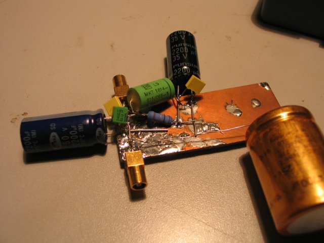

So I assambled, as usual, several experimental bypass configurations, and measured their impedance developing across a given frequency range. Basically, I would like to compare two configurations:
The latest [according to my knowledge] "snnuberisierts" bypass arrangement a' la Carlosfm, as it is described in
in this post
The other one is the simple [classic] 10000 uF//220uF// 100nF bypass arrangement applied in the MY_ref project of Mauro Penasa.
Though I could formulate this last statement also like this: "as it was suggested by Carlosfm half a year ago."
As it can be seen from the previous, I would rather leave alone for a moment the ubiquitous "snubber" problem, that is, the reservoir caps & snubber part. About that a lot was told and measured earlier on. And, as I 've already stated, it does not have a measurable influence on the local bypass impedance [on the amplifier pins]. Which statement does not imply that it could not have an effect in other ways.
So, what I would only test & compare here is this statement of Carlos:
Let us see if I was able to reconstruct correctly:
The snubber cap is 2,4nF, because it is that what I had small.
The 100 nF is the smallest possible 100V mylar cap. The resistor is
as described, 0.1W/1R. The 3,3uF I had left out for a moment.
There is a 4.700 uF reservoir cap connected, in some distance, to simulate reality.

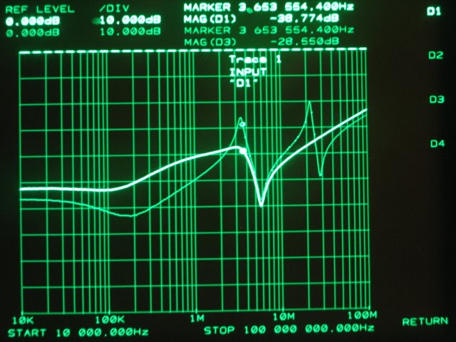

Now, I would like to take a pass backwards, and show a comparison between two setup:
The [highlighted] Trace 1 shows : 4700uF//2200uF(local)//100nF
The dimmer Trace 2 shows: 4700uF // 100uF (local)// 100nF
The second setup is the classic. It provides a reasonably balanced and low impedance reaching up to ~2 MHz, then peaks at 3.5 MHz, then we can see the beneficial effect of the small 100nF bypass cap extending up to ~ 40-60 MHz.
As it can be seen, changing the 100uF for 2200 has lowered the ESR value below 1MHz, and has emphatised the impedance peaking at 3.5 MHz, as it was expectable. [10dB difference]

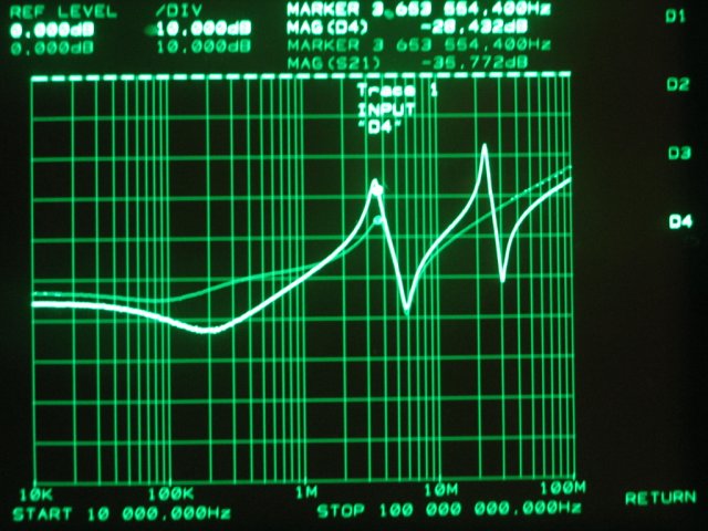

So, now I would insert the "snubber"
Trace 1 is highlighted & fully "snubberisiert": 4700uF // 2200uF // 100nF // .1ohm+2.4nF
Trace 2 is there for comparison, and is the classic setup.
Well, as I had suspected, we introduced some more ringing..

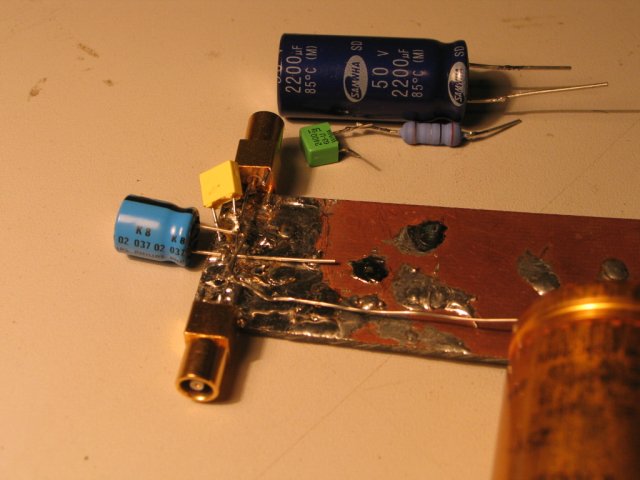

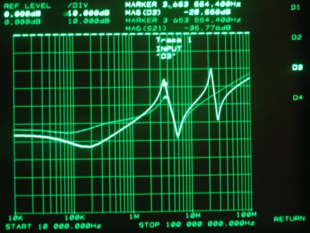

Ok, but there is one more thing to check: This was not yet the originally suggested, full setup: that one includes the 3,3uF across the floor.. that is, the supply pins.
So, I built the whole thing, two times 2200 uF //100nF, one piece of an MKT 1.5 uF /63 V across [I had this, reasonably small] and I am peeking into this assymmetrically, from the point of view of the, let's say, positive supply pin: [versus ground]

If you look closer, it can be observed that things got a tiny bit worse.

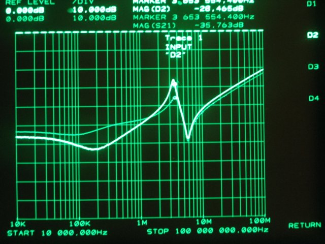

Finally, I would like to show what have happened when I've inserted into the "classic" configuration a "passing by" noname 220 uF capacitor:
Trace 1 is : 4700uF // 220 uF // 100nF
Trace 2 is the "snubberisiert" version, without the 1,5 uF.
What I see is that not always the quantity, also the quality is important: The philips 037 series 100uF /63V small cap has had lower ESR, and provided better bypassing..

So, what is causing the second spike (ring) in the snubbed example?
Have you tried the snubbed circuit either without the 100nF bypass or with some series R (.1 to .47 ohm) on the 100nF bypass?

So, that's all for now. [Measurement-wise]
Some personal conclusions [though it will be partial, I would like everybody to make up their own decisions].
In the classic, 4700 [or 10000] uF // 100uF // 100nF configuration we can see that the extra added inductance originating from the reservoir cap's own ESL + stray wire inductance gets totally absorbed by the local, 220uF - 100uF bypass cap. The impedance peaking visible is due to the local resonance, between the ESL of the small 100uF local, and the 100nF local. To eliminate / dampen this resonance the usual trick is to apply a snubber cicuit. The description and effect of such a circuit is here [as tried by me]:
snubber a' la Putzeys
In that thread I also had tried to explain the difference between Zobel / snubber networks, - at least, as I see it..
What Bruno had applied, I would call that snubbing, really.

Scottw,
What causes the peak? The snubber, naturally..🙂
