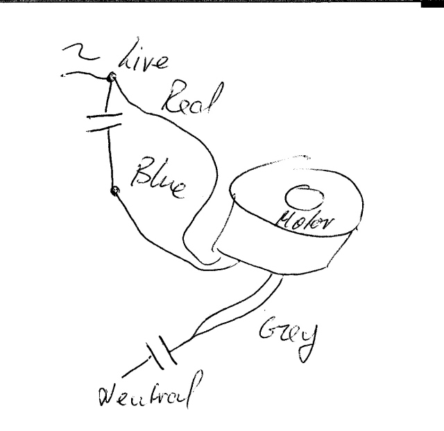

I need to build a Linn Basik Power Supply to experiment the connection of a Project Speed Box SE to a Linn LP 12 turntable. Can anyone provide me with the circuit and hints on how to build it?

Not sure what you mean then by basic Linn supply has more then 2 caps. I checked with a buddy who used to work for the Linn importer and an independent shop as a technician. His old notes on the Linn psu are: Live direct to red, Live via 0.22 mfd to blue. Grey windings are joined and go to neutral trough another 0.22 MFD cap. Same as Rega iow but different sequence of series connection.
Perhaps Linn may later have added a resistor to further drop voltage and reduce motor vibration. Beware though as the caps and motor windings basically form a filter that reduces the voltage applied to the motor. Adding resistance will change this parameter as well.

I actually saw a Linn Basik power supply in a second hand shop. It consists of 4 capacitors but I don't know how they were being connected. The shop ask for US$120 for this very old piece of work that I think it is too much therefore I started to look for a DIY.

I went to the second hand shop that has the Linn Basik Power Supply again. This time, I look more carefully into the circuit and discovered that there are 4 caps on the PCB.
2 x 0.01uF 400V
1 x 0.22uF 400V
1 x 0.22uF 300V
The 2 x 0.01uF are connected to the on/off switch, I think, to suppress sparks. The connection method is the same as tubnet.
I think I hit the jackpot and will try to build one this weekend. Thank you for the support that everyone provided here.

Yeah, quite sure the 0.01 mfd are to supress any arcs on the switch that could cause plops and twacks through the speakers....
Use Poly carb caps or similar for the 0.22. They affect sound quality!!!

I'm not sure what kind of materials are in which brand's caps. Preparing to use: -
RIFA 0.01 uF
Auricap 0.22uF
Are they good for this project?

It is the 0.22 that is important and Auricaps will be very good I would recon. They are polyppropylene and better then polycarbonate. Just thought they may be pricy for the application.....
