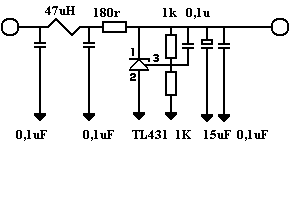

The LT1962 seems quite hard to find what about somthing simpler like a TL431 ?
