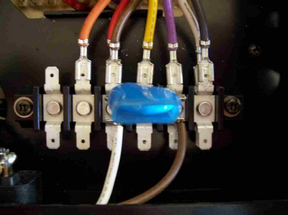

Hi Guys, wondering if you could give me a hand here. I picked up an old Rotel RA-820 stereo integrated amp second hand. Unfortunately for me in the USA, it's wired for 240v mains. The instruction manual mentions that this amp ships with different voltages for different destinations. Can anyone take a look at at the pics and tell me if it is possible to wire the PT for 120v lines?
HERE IS THE LINK TO THE PICTURES
http://members.cox.net/ted007ted/jbl/rotel.html
The blue and white wires are the primary side of the transformer. No markings on the unit or the transformer as to what the taps are. I tried googling Bando but did not come up with anything. Also there is no switch on the back to select voltages. I know I could buy a step up transformer, but the idea of changing the wiring is much more attractive. I searched this forum and read all the posts I could find, but no luck. Any advice is grately appreciated.

If you are carefully you can measure the primary voltage taps with a multimeter in the AC range as the transformer acts as an autotransformer. Connect it to the 110V mains and measure where 55V appears. Resolder the main wire to that transformer pad.
Thanks very much for your help. It makes sense and I will break out the multimeter tonight and give it a shot tonight.

Richard, I was able to convert the amp, listening to it now. You can not use the same method because you don't want to apply 240v at the 120v tap. Assuming that your transformer has multiple taps so it can be used at 120v, you can try this. Turn the unit OFF. With a decent multimeter, measure the resistance between the nuetral tap and the hot taps on the transformer's primary side (the side that connects to the wall socket). You should see resistance double as you go along the taps on the transformer. Then simply resolder the wire to the doubled resistance.

What happens if i plug a 110V unit into a 230V supply?
Probably the main fuse will blow. But additional damage is not uncommon. In this way never plug a 110V unit into 230V supply. Only the other way round will not result in a damage of the unit.

you could plug it in a 110V outlet and measure where the 240V appears in the transformer taps and solder it there. basically the same method. 😀

my findings
So...i bought a multimeter and tested the resistance between the neutral and the hot primary side...however there seem to be many wires coming from the transformer so i don't know which ones should be in which combination!
So now i wait to get a 110V transformer so i can power the unit that way and then test the wires to see where the 240V comes out....if you look at this photo, connected to the hot side is a violet wire...now i think that stays there but on the neutral side i think a couple of wires get swapped.....not sure if it requires two or one wire to make it run in parallel or series?
Attached a photo of current 100V config!
Richard
