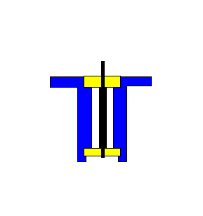

(actually bearing housing and shaft), back from the machinist. A little pricey ($240 USD), but beautifully finished. No pictures but similar to the Teres bearing housing except that the housing is in the plinth, not the platter (a regular non-inverted type), but I can easily move it from one turntable to another, and replacing ahigher grade bearings is very easy, as they are "electric motor" sealed types. Maybe I can make a sketch and post it....

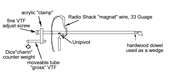

DIY unipivot...for ssmith and others...
No I actually haven't tried the DIY 12" arm yet, I have two turntable projects on the go....a Sugden Connoisseur BD1 in a Chinese Oak plinth and the arm board ( held at the appropriate distance from the main turntable with adjoining Aluminium bars. If I can get some photos when it is done I'll post them...) and my Garrard "LAb 80 manual", which is what I had the bearing made for. The lab motor will be attached to a granite sub-plint, with a maple mainplinth supporting the platter and tonearm. I'd like to do a sort of Roksan TMS or Xerses 10 clone...
I have used RadioShack magnat wire as tonearm wire and even the 33 guage stuff creates it's own lateral resistance . As the arm pivots a small torsional force outward is exerted by the wire on the tonearm. I have tried everything to minimize or remove this effect to no avail. It is quite small in magnitude.
I used an Easton arrow shaft that I bought at a local archery range as a "practice" arrow for $1USD. I may have to dampen the arm tube with some foam or balsa wood inserted into the tube. I think I have $5 CDN into it....I will post pictures or a hand made sketch if I can...

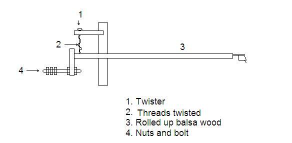

I've decided to try rolled up balsa wood, see this thread, which means I can also run the wiring on the inside and maybe damp the wires using teflon plumbers tape. I think it would also be possible to roll up that balsa wood in a way that it is tapered.
For the anti-skating, I'm going to try to dangle the tonearm from a few threads twisted together (like silk or fishing line), which can be twisted by some kind of nut at the top to provide the lateral tension. I've done a diagram -- which is not very good (I used Microsoft Paint...).

I'm using a standart off the shelf shaft and sleeve.
a 3/4" and 5" long thompson shaft cost me about $10. its polished and hardend to 60 Rc. a bronze sleev was harder to find with high tolerance & with an exact .750" ID I used 2 of them forced into the plater and had to grove one to add a snap-ring on top.
I can send an Autocad 14 drawing if you need.
Total cost was under $15

Sounds interesting -- and would love to see the autocad drawing -- either PM it to me via the board or enclose it on the thread -- maybe useful for other people.
Your off the shelf solution sounds great. I've been looking at the McMaster-Carr site, and they have tonnes of shafts, sleeves, bearings, collars and so on (and all fairly cheap) -- would useful to know what fits what and how to put something together that attaches well to a simple plinth and platter...
Autocad files. and tonearm bearing.....oops did I pay too much?
I don't think so because of course it is absolutely beautiful and the machinist donated quite a bit of his time to my cause...and I have to rationalize the expense somehow🙂
$15 for a turntable bearing is absolutely great, an inexpensive alternative for turntable DIYs....
IZHAKKATZ could you email me the drawing? I may be able to convert it to another format (maybe PDF) and repost it here if you would so choose.
ssmith, I think that the anti skate mechanism using twisted pairs of string or thread or whatever is quite simple, and dare I say a little clever...good for you.

Nothing original - I think I got the idea from somewhere in these forums! The key will be to use thread that is rigid, so the arm doesn't wobble from side to side (I think).

ssmith, I "stole" your tonearm sketch and modded it to look like the one I built (I hope it's ok with you to do it, if not I apologize)
Magnets can attract each other (opposite poles towards each other) or repell (same poles towards each other). The magnetic field is related to the distance between them.. I can't remember if it is directly proportional or inversely proportional (I think it is inversely). with a little work, and some playing around it could be interesting to implement it.
