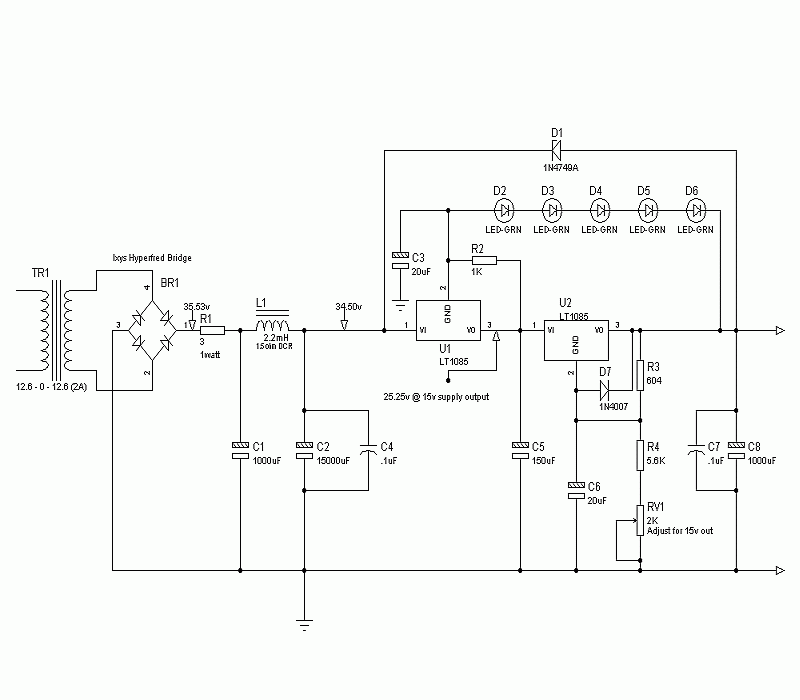

Hi All,
If any of you have looked at the "using back to back LT1085s" thread this is the same reg but the requirments have changed and I want to make sure that I have it right before I have the boards made. I now only need 15 volts. I should be dropping about 11 volts across the pre reg and about 8 volts across the output reg. I know that the output reg is adjusted properly for a 15 volt output but I'm not positive about the pre reg. Can anyone spare a few minutes to help me?

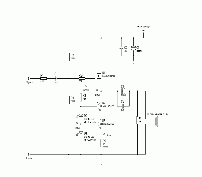

Hi Peranders. Well the circuit is a tracking regulator as I'm sure is obvious to you. Why use it? Well I guess just for really good regulation for the circuit below. Is the load constant? I don't think so but I'm not going to give you a definite no because I'm not sure. The current load on the PSU could be anywhere from 233mA at idle to 1 amp on loud passages. The circuit below is a modified Szekeras headphone driver. The reg I'm sure is probably a little overkill but not really that expensive or hard to build so what the hell. Thanks for replying.

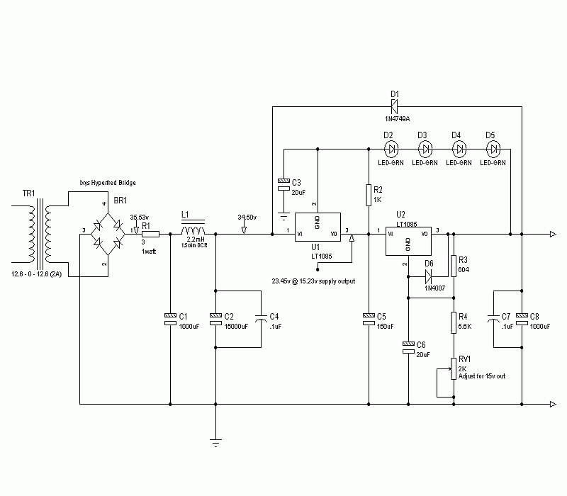

Well I think I have it now. The current through the 1K resistor should not change so all I needed to do was add one more LED and this should give me a 9v drop across the prereg and about 10v across the regulator for a total drop of 19v.

Suggestions to consider:
1) Increase the 5.6 K Ohm resistor and (possibly) decrease the trimpot -- if you want 15 Vfigure out what the total of the two should be and make the pot perhaps only 10% of the total. That way you get a finer control. Or increase the 5.6 K and use a parallel resistor alongside the 2K trimpot to effectively decrease the trimpot so that if the wiper opens you don't totally lose it. Of course, the circuit doesn't need or particularly benefit from 15.00000 V so maybe you can just use a fixed resistor here with no trim. [ I remember watching Julia Child say "put in EXACTLY 1 tablespoon of salt" while throwing in a careless handful of salt to the pot ]
2) Take the suggetion above of using a power resistor to drop the first 11V, Use 1 LT1085 for the 15V rail, and use the other one for the 10 V gate bias; feed it to the gate through a 100 K resistor instead of the 100K and 200K voltage divider. You could also use the second one to feed the Q2/Q3 current source after appropriately adjusting the value of R4.
3) Like 2, drop 11 V with a resistor, use 1 LT1085 for the 15V rail and the other connected as a 233 mA current source [LT almost surely has an app note on this] in place of the Q2/Q3 current source.
I don't quite get the benefit of cascoding the Q3 current source with Q2; the output conductance of the current source shouldn't really matter because you have a 1K resistor and the load effectively shunting it anyway, and the cascode eats into the available voltage headroom before clipping.
Suggestion number 1 will make the circuit easier to adjust and perhaps more reliable.
Suggestion number 2 would probably have the most beneficial effect on the sound because it would allow a stabilize the bias point of the mosfet with a regulator that has no variation in its current demand.
Number 3 is for experimenting -- who knows if the LT1085 as a current source sounds as good / worse / better than the discrete circuit.
