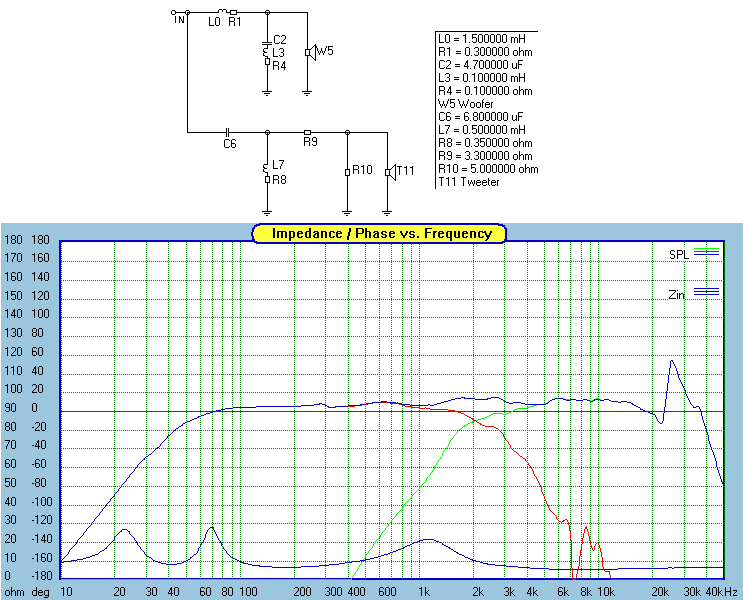

I will like to build this design as a floor stand. I can only place my speakers near the wall with about 20-30cm to spare at the back of the speaker to wall. I understand the BSC is about 5dbs.Will this be too high for my application, if so ,what can Ido? peterpan

To reduce the bsc (or lift the mid-high) I suggest to lower the series inductor (L1) to 1.2-1.5 mH and also tweak the lpad on the tweeter (reduce the series resistor and increase the shunt 3.3 in series and 10ohm shunt will do the trick).
You have to try yourself what sounds best, it's next to impossible to design from a distance without knowing the design 😉
LaMa's advice is excellent. In fact, I had previously made up a reduced BSC version of this crossover. This gives a couple dB of lift to help compensate for the closer location to the wall. Here it is, followed by a disclaimer:
Ok, now the disclaimer. Most speakers sound better further away from the walls. They will have smoother response and better imaging. The closer the boundary, the higher up in frequency the related dip and peak in the response from the out of phase reflection. As these response issues move higher in frequency, they become more audible.
Of course if you have placement limitations, almost all speakers will have have the same issue and there's not much you can do about it. I'd just like you to be aware of the issues.
John

Thanks, luckely for me you published the original cross-over otherwise my educated guess wasn't so educated 😉
Did I get this right?

Seeing the alternative x-over just being changed in the major coil and the tweeters parallell resistor, I make the assumption that its ok to tweak in the whole range from 2.2 mH -> 1.5 mH and 3.9->5.0 ohms without wrecking et.c phase tracking, lobing up to much.. or is ??

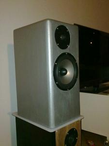

o.k, now my Zaph L18 are done. For now. The filter has two options, full BSC and the "close to wall option", easily selected by two switches.
Volume is 19 litres, tuned to 40 Hz.
Hammerite silver is a wee bit bright, so in the future i´ll sand em down again and will mix silver and black hammerite for a more graphite-ish look. And then i sure will use a roller... So no close up shots this time.
Thanks again for a clean sounding design. / A Hoegberg , Sweden
