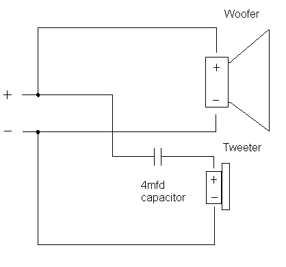

Have you considered a more complex crossover? It seems too simple to me...
Have you taken any measurements with them yet?

Brian-
I've been using the Vifa drivers for years and I've found that a simple high-pass filter seems to work well. Lacking the necessary test equipment, I'm reduced to subjective listening tests. But this has worked for me. I don't claim to be an expert, but I am happy with the results.
I've recently downloaded Speaker Workshop and I do plan to do some testing when time allows.
I helped work on one of chrisB's speakers -- a Vifa P13 + modified Vifa T project. We started out with a fairly complex modeled XO and ended up with a single cap on the tweeter. IMHO if you can get drivers that match well and where the midbass rolls off smoothly this is the best XO there is.
It is all i have on my current system (+ an active XO on the bottom).
dave
