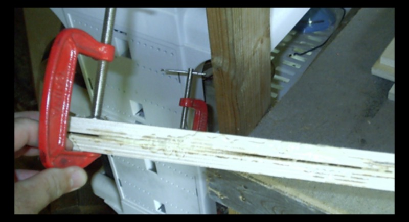

I hate askin the UN for help but I'm desperate. These speakers are taking forever. First I listened to Planet10 and Bill Fitzgerald debate MDF or ply. Then finding a design I had a chance of pulling off. This will be my first home speaker. Then the problem of finding Baltic birch. I found a great deal on 1/2" Baltic in a town 40 miles away, I got three 5X5 sheets and a table saw.
Then hurricane Dennis came and I had to put the birch ply on my windows ! Geez, what next ? o.d.t.a.a.

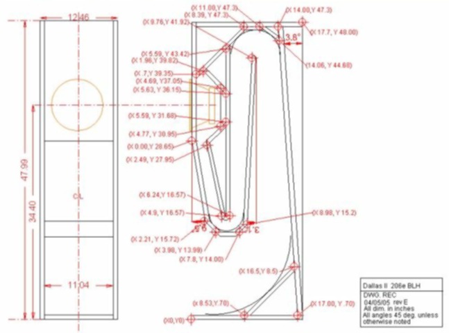

Because Ron Clark's Dallas II plans call for .700" ply and my wood was .500" I did some redesigning to keep the cross section of the sound path the same area. I thought a double thickness baffle would help the sound. I also thought the center fold should be doubled since it was 27" long and only supported by the sides.
...now the big mistake...
I used Gorilla glue to laminate two 27"pieces . The glue expanded and there are gaps around the edges. I had enough wood left over to remake the baffles and the lamination worked well with the yellow glue. I don't have enough birch left to redo the 27" pieces so I am now trying to fill the gaps with yellow wood glue (pva?)
Would I be better off continuing to do this or should I just use 3/4 MDF for this one piece ?

The UN simply doesn't have time to handle all speaker-related issues brought to its attention, but I will make an exception in this case.
In my experience with speaker building, I screw up a lot. So while I am not the person to ask questions of concerning good planning and execution, I may be able to advise with fixing things that didn't quite work out as planned.
I always use a little caulk to fill unplanned gaps. Some say rope caulk works well, but I like the lazy way with the stuff that doesn't require a caulk gun, but oozes out of a pressurized can with just the push of a finger.
I'd stay away from filling gaps with wood glue, but only because its messy and I don't think it will fill the gaps quite as well as caulk.
Good luck with your project!
Kofi

Has anyone looked at my first attachment ? Is anyone else planning to build one of these ?
Koffi - I think it's about time you setup a commitee on abuse of the public by the audiophile press 😉
Hey squalor - I like the cut of your jib me lad
Must been damn difficult with all of those angulations. Well done.
What the hell are these anyway? Your own design? What drivers are you planning on putting in there?
Just a tip in terms of applying ply externaly as a covering. Try cutting it slightly ( 2 / 3 mm per side) oversized, fixing the ply covering in place, and then using a router with a bearing guide flush trim bit to get it to the correct size.
As long as you have a reasonably sharp bit and the right RPM set it should give a cleaner finish than any saw.
As for bracing - I would imagine that none would be necessary here - I may be wrong!
These are Dallas II designed by Ron. Most of the angles are 45. They are designed to use the Fostex FE206E but with some modifications (suggested by GM i think) they can use the 208 sigma. I have 206e that may be getting a phase plug and other tricks but thats for later. First I need to finish these cabinets. I bought MinWax stain and a gallon of MinWax fast dry gloss poly
