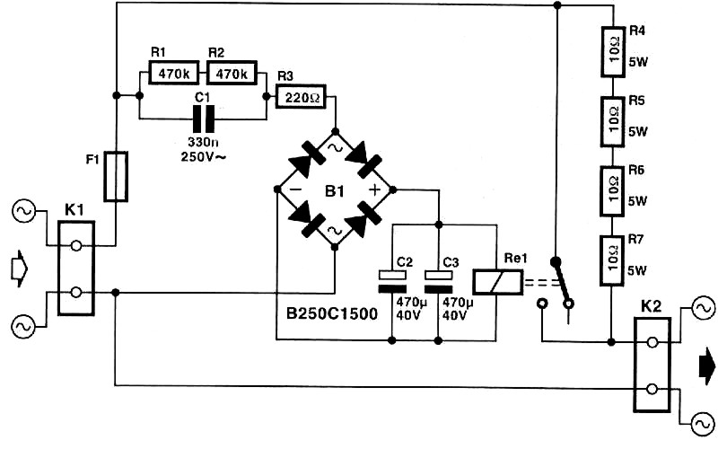

I have built a soft start circuit that was published some time ago in Elektor. I am using this circuit to power 1500VA 230V toroid for Super Leach amp. The relay is 8A constant and 15A max or 2000VA rated.
But after some time the contacts stick together. I increase the time delay to 3-4 second, but it happens again!
Any suggestions how to solve this problem?

You don't specify what you mean by the contacts sticking together. Do you mean that they permanently stick and you have to replace the relay? The contacts may be weldeding themselves closed due to excessive switching current.
Without a schematic of the circuit it's hard to be specific but in general, a relay for soft start should not engage while there is a potential for high inrush current to flow through the contacts. Perhaps you PS caps are so large and the limiting resistor such a high value that the caps have not had time to charge by the time the relay closes.

Don't know which elector soft start circuit this is, but I had a similar problem with a soft start circuit from elector with a similarily rated relay..
This circuit used a delay acheived by charging of a pair of capacitors. As the capacitors charged, the relay would eventually close.
Now, my relay stuck in the closed position. This was probably due to welding as I had (I found out) miswired the trafo, thereby drawing very high current.
Anyway, once i got the problem solved, the relay would work fine.
The obvious answer would be that the relay is under-rated, but I think it is more likely that, assuming capacitor delay, the slow increase (and decay) of the relay coil voltage caused by the capacitor charging made the relay close and open relatively slow, thereby making it much more suceptible to arching and contact welding.
Maybe this one!
Maybe they were talking about this circuit.
Although there seems to be another more accurate version.

Yep!
That's the one I was using!
With my 600VA toroid it is working perfectly! (after I fixed the miswiring that would cause 10A fuses to blow instantly when the reistirs were bypassed!)
I did however change the resistors to two 33ohm/17W ceramic resistors mounted off the board. Probably totally overkill as they don't show no sign of heating whatsoever, but then they will probably last.. 🙂
I came across this circuit in an Elector magazine with an article on an amp called "millenium Crescendo" and was there used in conjunctionwith a 250VA toriodm, but I think I saw somewhere else that this circuit should be good for up to 1kVA.
