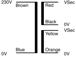

The diagram for a transformer is more helpful than the 25-0-25 description! What this means is that there are two secondary windings. One will output 25V, with respect to ground and the other will give -25V. The reason for this is that they are centrally tapped and that centre tap goes to ground. What you can do is connect ground to the bottom pin and ignore the centre one. Then you will get 50V from the top pin. (Vice versa will give you -50V) but using this method - you cannot get +-50V
I hope that is clear enough! I have enclosed a crap diagram to confuse you more!!!

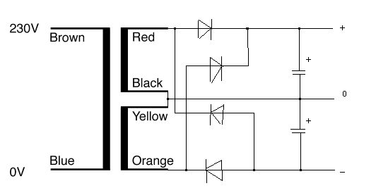

Great so just to see if Ive got this right, if I connect the black and the yellow together I can use this as 0v. Then the orange would be v- and the red v+ is that about right?

Black and yellow together forming the center tap is right. But the rest doesn't matter. It's the rectifier that establishes the DC polarity. Doesn't matter how you hook up the orange and red leads.
As someone else mentioned, dots are sometimes used on the transformer's schematic to indicate which leads have the same relative polarity. And this is important to know when you have a transformer with dual secondaries which can be wired in series or parallel.
For example, if you wanted to create a center tapped transformer, if you connected the two leads with the dots or the two leads without the dots to form the center tap, you wouldn't get any output as the two secondaries would be cancelling each other.
Similarly, if you wanted to wire the two seconaries in parallel, if you wired the lead with the dot on one secondary to the lead without the dot on the other secondary, and vice versa, you'd also get no output.
But once you've got the secondaries wired correctly, the concept of + or - is irrelevant as far as the rectifier is concerned.

PMA said:Like this...
Right. And if you swap the red and orange leads, you get the same result.
