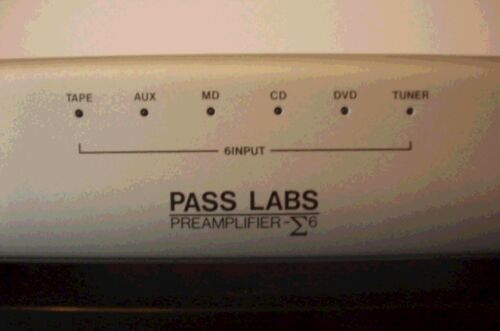

Hello,
Why not try Letters C.
Little time consuming, but very easy way for labeling.
Final results can be better than most comercial products.
After all labels applied, they can be protected against
scratch by matte transparent varnish.
Use long time drying varnish (12-24 h).
I used same way on my projects, and they all look superb.
Best regards,
Kristijan Kljucaric

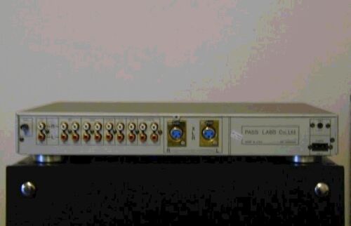

For chasis, I brought Technics SU-C1000 preamplifier and then removed all electronics.
After that I removed all buttons, central Ni-Cd batteries, LED's, pots, power switch ...only source LED's (I replaced old ones with high intensity blue LED's), volume and selector pots are left. The remaining holes was filled with epoxy filler, than I painted whole chasis with silver eloxal paint and applied Letters C for labeling the source LED's, selectors, and back-plate with connectors.
Then all together was sprayed with several layers of matte transparent varnish and enclosure was finished. The final look is superb and there is no way to tell that is hand-made or modified.
Also, in the Passdiy gallery, and on my website there are some more photos of the preamplifier and minidisc that are labeled with
Letters C.

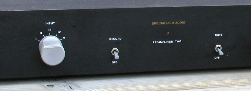

mbroker,
did you try your local printing shop?😉 I didn't, but I'm doing Letraset lettering on my panels all the time and it's not frustrating at all. I don't use any laquer, because I prefer original look of aluminum. This panel was done 20 years ago (no anodising) and it's still looking good. It is cheap, fast and long lasting method for lettering.😉

This is true that if you have good connections with such shop, maybe it is preferred method, but still for a single unit the setup procedure seems to be not worth the efort.
The letraset system is easy to apply, and if after a time you wan't to change something it still doesn't present a problem, beacause you can erase it easily.😉
