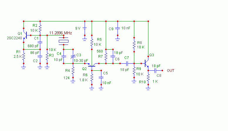

I think there was a thread about this some time ago.......just can't find it. Anyway, it is probably too old for any of us to remember what we were arguing, er, ah, discussing.
Anyway......here is a slightly different version. The idea was inspired (or ripped off.....) from yet another ham radio book. The change is that it uses a common-base stage (Elso.....are you reading this......?) at Q2; instead of a 22 ohm resistor to pick off the crystal current. The input Z of this stage is around 5 ohms, so there is somewhat less Q degradation.
Jocko

I know that sooner or later, some wiseguy will fuss about a capacitor in series with the crystal. So for those of you who are new at this.....and for those that ought to know better, but don't.......
This circuit operates in the series-resonant mode. When ordering a crystal, you can either specify series-resonant frequency, or a parallel-resonant one.
Both cases refer to the frequency at which the crystal exhibits a series resonant frequency, usually in the range of tens of ohms. This is not the anti-resonant frequency, which is the equivalent of a parallel tuned circuit, and therefore in the range of many kilohms.
For a crystal spec'ed for series resonance, they measure the resonant frequency with only a resistive load, usually 50 ohms. The only capacitance is the stray holder capacitance, etc., usually around 6 pF.
When you spec for "parallel resonant", they measure the series resonant point using the specified load capacitance in parallel with the crystal. Typical values are 20 and 32 pF. This frequency is a few kilohertz higher when measured this way.
Most crystals you see in parts catalogs are spec'ed for parallel resonance, as the most common clock circuit around uses that type. It might be easier to order a crystal that way, because it will work in any circuit. In the case of a Butler oscillator, you can simply put a capacitor of the proper value in series with the crystal. The circuit will work just as well.
Jocko

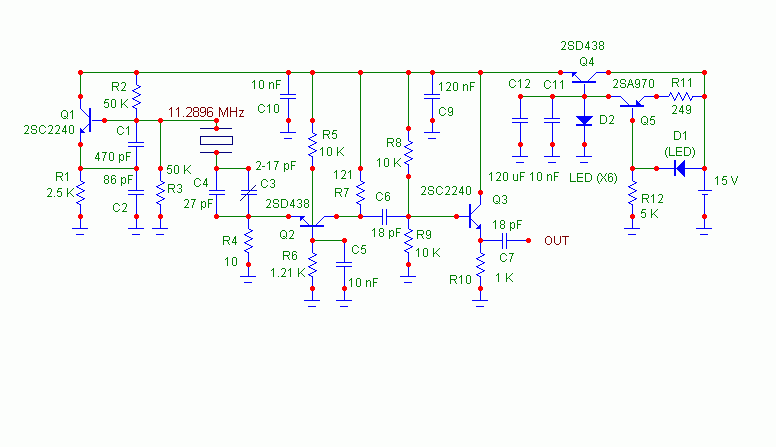

A slightly different version....
The common-base stage runs at around 50 mA. (Are you reading this, Elso?)
So........is anyone going to try to build this? I know what it sounds like, but what do I know.
Jocko
Sine wave......
And low harmonics too. That way you can put it outside of your player, feed it in at a low level without radiating crap all over the place. Then square it up once inside.
Also will let you feed it into a D/A box using.....say....a DIR1703 to sync up things.
Jocko

I think it only puts out about 1 V rms or so. (I forget........yet another senior citizen moment.....)
The first go-round uses a '04 inverter set for a gain of 4 to square it up. Maybe next time I'll come up with something more exotic.
Jocko

Scale C1 and C2. For 24 MHz, cut them in half. C3 & C4 are adjusted so that the crystal will resonate into the load it was cut for. You will need to know that.
As for the inverter........yep, you can configure it just like an op-amp. The output level of that circuit is too low to make a square wave without some gain somewhere.
Make sure that whatever you do has a stable PSU, or all that work to get low phase noise will be gobbled up by jitter in that circuit.
Jocko
