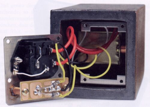

First the PSU opened:
Now everybody can see clearly that they use half-wave rectifying (like NAIM, and like I have always proposed...), that means two secondaries with two diodes only for a single output voltage. The diodes seem to be the already mentioned General Semiconductor FE5B (or C), 5Amps rated. Considered the size of the DAC including the ceramic case (7,6 x 7,6 x 14 cm), the transformer is quite small.

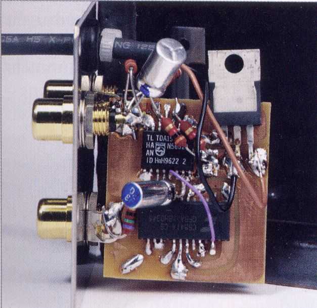

Second the DAC opened:
Here the image does not reveal the complete secret, but a lot of details nevertheless. The pcb looks very much "47labs-style", a bit DIY too much, considered to the efforts of some of you here. It is a mixture of p2p and pcb, it has to be like that, I think, although some details (the blue wire!) looks like an afterthought.
The DAC uses a single regulator (a 7805 perhaps), smoothing caps are either non-existent or not visible. SPDIF input (with a carbon 75R resistor) goes into a CS8414 directly. The pll filter uses an elcap (or is it the smoothing cap for the digital supply side?). The ShagirakiDAC uses a TDA1543 not in the DIP8 case, but in the 16minipack smd size, recognizable by the 8 "outside" feet soldered together, although the exact number on the chipcase is not fully readable. Maybe the heat dissipation of this package is better the smaller DIP8 chip. Two 3k carbon resistors are soldered on top of the TDA, maybe the IV conversion resistors. Another stripped cap is visible, maybe one of the output caps.

If I see correctly, they use a cable between SDATA and DATA. I thought this was one of the most important connections since the digital data is led through there. then why a cable and no hardwire between the pins? Am I wrong? They chose to wire FSYNC and SCK as short as possible. Can anyone think of a reason? Why are they so important? I can read in the datasheet what the pins do but don't quite understand it.
Bit clock and word select connections are surely as important. Without a correct information here the data stream is worthless, I think.

Has anyover ever experimented with hardwiring the SDATA against hardwiring FSYNCK and SCK?
And does it matter if I bend the pins on the chips? Sure, I shouldn't do it to much since the metal will break, but if it doesn't? Will I lose quality or is it just smart configuring? ;)
