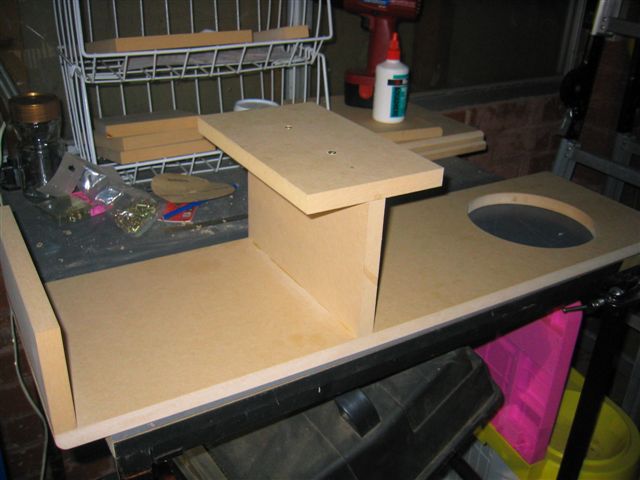

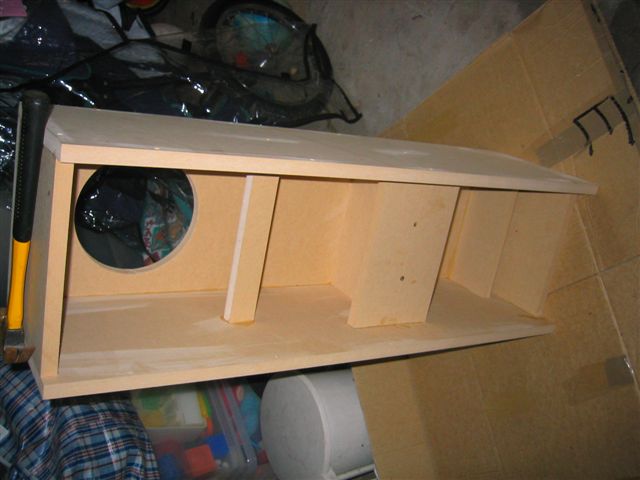

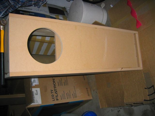

Just finished Audio Nirvana 8" with double vent cabinet.
Outside dimensions (mm) : H900 X W286 X D250
Inner vent (mm): H50 X W250 X D150
Outside vent (mm) : H25 X W250 X D100 - flared radius 10 mm
Box made of 18mm MDF screwed and glued
Padding 100 mm acrylic wool on front baffle. 10mm Acoustic mat on rear panel just behind the speaker (w250 X h300).

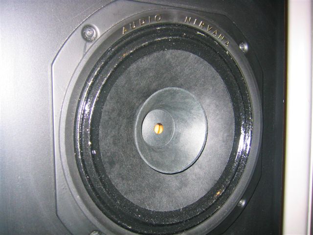

I'm kinda new here so please pardon all my questions. Is Audio Nirvana new to the market ? Why do more people not use them ? The I see specs are very close to Fostex. Commonsense Audio is a sponsor here too.
Was your cabinet one of the plans on the site ? Is that wood veneer or vinyl ? How much was the shipping ? What amp and source do you use ? I wonder if the 6" would work IB in a car door ?
These drivers are suppose to be Fostex replacement. They are cheaper and are said to be better (said by the guys who are selling them 🙂 ).
They look very similar to Fostex, though. The basket looks exactly the same. There is same plastic ring and the cone looks really identical to Fostex, except it's black and the dust cup lucks small net. The surround suspension is diffrent, though.
I think same company is manufacturing drivers for them and for Fostex...or Fostex is producing them 🙂

The AN6 I have differs in every detail from the FE167E. The frame is different in all dimensions including the mounting circle. The AN magnet is the soft refrigerator magnet material while the Fostex is ceramic. The cone material is a different paper. The AN has a pleated paper surround while the Fostex has an impregnated cloth inverted half-roll surround. The AN is made in China, while the Fostex is made in CHINA -- the entire FE series production was moved to China in the last year.
Now I don't know why theory requires a rubber surround give better bass than a pleated surround, not that this is relevant, or why the AN should perform better in the upper end. My observations are that the two drivers perform about the same at the bottom while the AN suffers from more mid-range shout. The AN screams cheapness -- every corner cut. Why, with that huge magnet, does the AN6 have the same BL product as the FE167E?
The American market is driven by price with near total disregard to quality. I think that the AN6/FE167E comparison is a reflection of this. If you feel that OK is good enough, then go with the AN6. If fit/finish and overall appearance are important, go with the FE167E. I feel that the FE167E has a somewhat better overall sound as well.

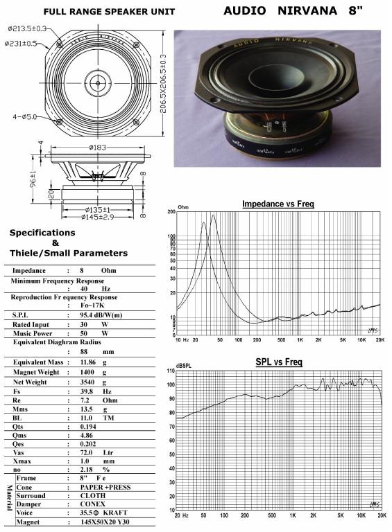

Audio Nirvana 8" Specifications

For those interested, I have attached the specifications for the AN 8" as provided to me several months ago by David Dicks. I do not know if this spec sheet is still current.
The FE206E specifications:
http://www.fostexinternational.com/docs/speaker_comp/pdf/fe206erev.pdf
The AN8 has a heavier (bigger) magnet, but a lower BL! The AN8 also shows less output in comparison to the FE206E below 2k. Based on the plot, the AN8 may be more suitable in a TL or a BR?
However, I have not heard the AN8, so I will keep my comments to a minimum.

Fostex themselves recommend a double-bass reflex for their FE207E:
http://www.madisound.com/pdf/fostexcabs/fe207e_enclrev2.pdf
I forget the design rules for DBR, but they exist, and you can double-check/tweak the design on several different pieces of software, including Martin's. But if the AN8 is truly a "drop-in replacement" for the FE207E, you could just use Fostex's design.
But I'm with Bob concerning the build quality. I mean, simply look at the photos on the commonsenseaudio web site. And that's not even considering the inferior magnet.
