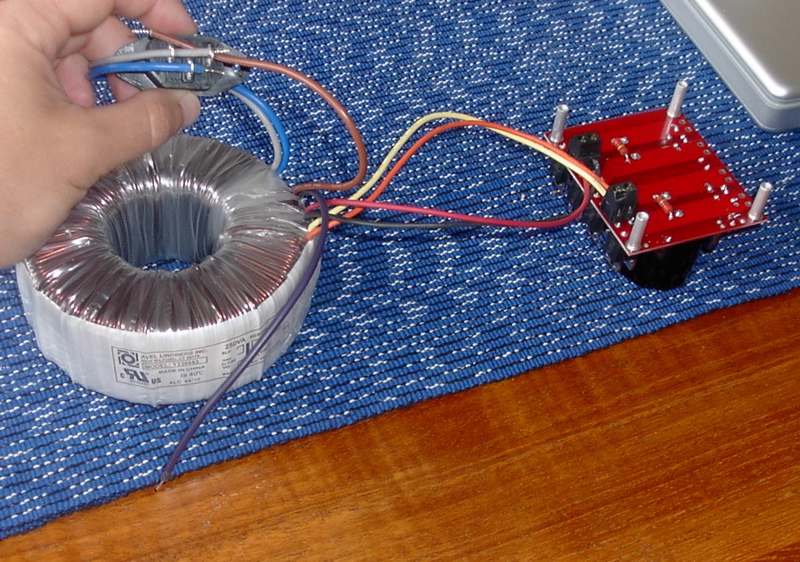

Is this right?
Thanks for the help and thanks for the link homer09. Here's a test run. I need to put the fuse in line with the grey wire, right?

not quite - tie your blue and violet wires together. connect them to your fuse and the fuse to the hot lead of the IEC input (put a switch in this line unless you want to be on all the time) connect your gray and brown wires together and then to the cold side of your IEC.
blue
. >--- fuse --- switch ---hot lead
violet
gray
. >-----cold lead
brown
Use insulated terminals to make the connections, as a soldered joint could potentially fail and allow the hot lead to contact the chassis.

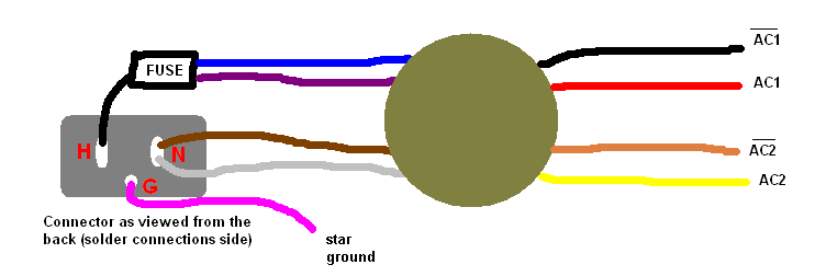

:att'n: Dont connect what your showing in the picture!
i hope my picture is clear.
Now if make sure your power cable is also wired correctly. your fuse should be inline with the right hole in your wall socket (the smaller one, its smaller because its the hot, so your finger doesnt fit as easily :hot: )
connect your power plug to your chasis, dont plug to the wall, and check with a DMM that there is a connection between the fuse and the hot prong, this is very important, a fuse inline with neutral is useless.
On my picture,
H is Hot
N is Neutral
G is Ground (connected to the star ground, not to your transformer!)
Notice the lines over the AC1 and AC2, these are like on Brian's board, match them.
For best noise reduction, twist together the red&black, orange&yellow, blue&grey, brown&purple. Make sure there is no electrical contact between twisted wires as they will cause a short.
If you have a doubt about anything, ask, this could get ugly if you dont. maybe even take another picture with everything wired right before you plug in for the first time.
