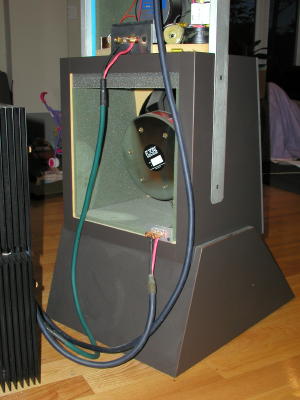

The dimension is 17'x18'x10'. Woofer is Focal Audiom 15'. I'm using electronic crossover at 100Hz. In room freq.response is -3dB at 25 Hz. However, I'm also using another 12' woofer on top with slightly smaller enclosure. My point is that the size of a baffle doesn't really have to be big. No frequency correction was required.
The effective baffle size is larger than your dimensions would suggest seeing as it's a folded baffle. It's effective size is more akin to a flat baffle measuring 37" x 38". Hell, slap one more side on it and it's infinitely large. 🙂

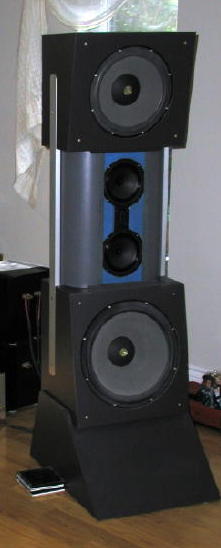

It all depends on aesthetics. I wanted my open baffle speakers to look nice and not too big (or rathe wide😉 ), that's why folded enclosure for woofer. The baffles are sloped so less resonances I hope. I also think that sloped pedestal has something to do with the bass response (took it from Wilson WAMMs), because although I'm not using any low frequency correction circuits, the response is down to 25Hz without a problem. Open baffle produces the best bass you can get.
A friend of mine wa so impressed with the look of mine design, that he took out the drivers of his cheap 3 way system and built enclosure similar to mine, placing his drivers there. He said that they sounded way better.😉

Peter,
“My point is that the size of a baffle doesn't really have to be big. No frequency correction was required.”
I sure you’re getting the bass you say you’re getting, I just don’t see how you’re avoiding the cancellation below 100Hz.
One of the problems in trying to analyze a speaker’s bass output is that the wavelengths are so long that you can’t ignore the room interaction. In the final analysis, the placement of the woofer in relation to room boundaries will always have to be considered. This is even more true with an open back system.

And this is what matters. The speakers would probably not produce much below 100Hz in different invironment, but I design them for my room and I'm quite happy with their response there. Should I ask for more, or complicate things when it's not needed?😉
I also have to point out than since their creation in 1996 I used them in 3 different rooms and results (or measurements) were always similar.
