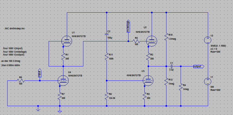

Ok, first all the usual disclaimers. These are sims. I haven't built this circuit and confirmed the results with measurements. The tube models aren't mine. I'm not responsible for any damage or harm resulting from implementation of these recommendations, no animals were harmed in their production, do not employ under the influence of strong medication, etc, etc..
First the 'stock' circuit, the closest tried to yours but not exact.

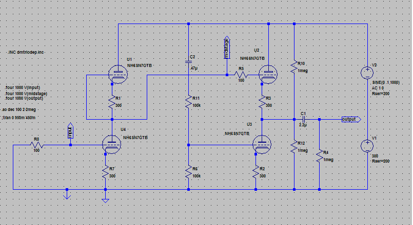

Now the 'optimized' circuit. The rational for the changes was guessing that for optimum operation the AC voltage seen by the grid of the lower output tube should approach as closely as possible the mid point between ground and B+. The lower resistor in the divider is in parallel with the lower output tube grid circuit alone and the upper resistor with the full upper tube, it stood to reason there was room for improvement. The DC blocking cap is also a factor. The same reasoning was applied to the output resistive divider.
Here's the new circuit.

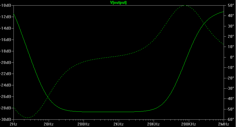

And the resulting PS rejection. The changes made don't appear to have any effect on the slope of rejection at high frequencies other than allowing it to reach further down. Increasing the size of the blocking cap lowers the frequency and further deepens the null. The good news is it appears possible to target right where PS supply noise is worst. The bad news, tuning this deep is highly sensitive. Substituting 125k for the 124.5K resistor value reduces the null to -63 dB, 120K levels off at -45 dB. Even getting close though provides significant PSRR improvement. The approach I would take is insert ten-turn pots wired as a variable resistors in series with those to be tuned and adjust for lowest output hum, maybe temporarily undersizing the power supply caps to make it easier.
That's what the sims suggest. It would certainly be cheap and easy to try, curious what results if you decide to give it a shot.

I notice your schematic is a little different from Broskie's original. You have no 1M resistor divider on the top output tube, as Broksie suggests for safety. Indeed you have 1M dividers on the output where Broksie only has 100Ks. What is that about.
It's been so long since these were done I had to go back to Tubecad to see what you meant. It appears Broskie posted multiple versions himself. Some don't show the 1M divider on the output upper grid, others miss it on the output proper. It's also possible I was just playing around trying things at that point. The above trend seems to hold over multiple versions though. One I tried substituted a capacitive divider and high value grid resistor for the resistive divider and the general results were the same with different knee points.
Revisiting this last night yet another version was tried, shorting the blocking cap on the grid resistive divider to permit DC flow and capacitor coupling the mid point to the lower output tube grid, the latter properly referenced to ground with a resistor. Same, maybe better PSRR result after tweaking though I don't know how it affected distortion or operating points. It might be a handy alternative for loading down an LC or VR power supply.
