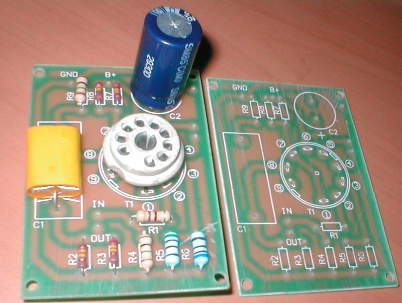

bonny_kjs has offered us help. He could make the PCB and would offer the boards for cost and shipping (as a groupbuy requires)
I'd be interested since a pcb cad learning curve alone would take me a while..getting the right shapes etc. especially.
Here's a sample of his previous work :

Great! The more the merrier...It might take a while though. I have this feeling that we are going to have some good arguments settling on the final design.
Let me start by asking a few questions that need be answered or come to mind
1.) PSU or no PSU on PCB?
2.) DC current regulation only? or even onboard filament "stuff" or not?
3.) Fixed socket type or no?
4.) Safe version or not?
5.) Pot included to tweak the 50% psu injection into grids (see improving the Aikido thread)
6.) Width control added or not?
7.) Tube rectification or not..my preference is for Hybrid Graetz bridge
Bas
