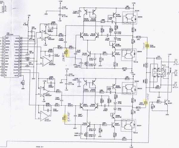

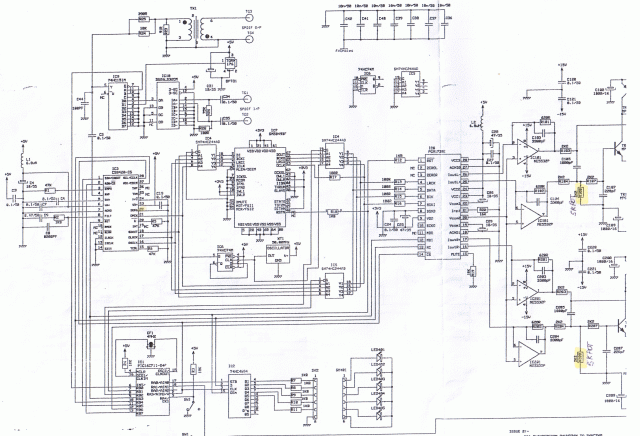

I have the PCM1738e in my Musical Fidelity A3.24, but it does'nt have HDCD, it' a 24/96 or 24/192 switchable. Below is 1/2 of the circuit as my scaner can only do A4 and it's A3. I'll do the other 1/2 in another post.
Cheers George
