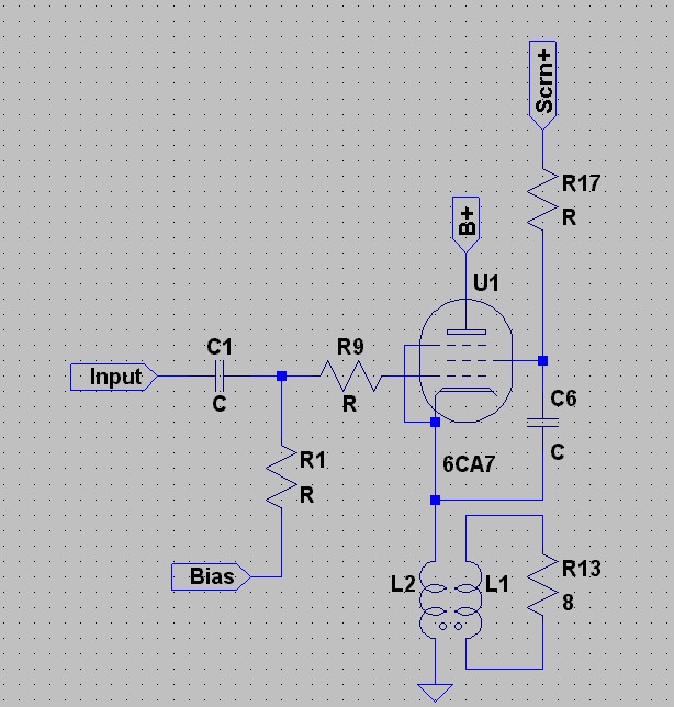

A couple of questions regarding the biasing and load impedance for CFs such as shown below.
1) Given that the OPT has a non-zero DC resistance it appears that the DC voltage drop would have to be considered in the selection of the grid bias voltage. In fact it would appear that with the right combination of DC resistance and idle current the circuit could even be self biased. For example for a 6CA7 I belive that -14V gives about 100ma. So if the transformer had a DC resistance of 140 ohms the grid could be connected to ground.
Is my understanding of this correct? I imagine that depending on your transformer to provide the right resistance might be kind of risky though wouldn't it?
2) I have seen recommendations (for CC amplifiers) for using the same or even lower impedance OPTs for pentode connection v.s. triode connection. Can anyone explain the relationship of rp to optimal load impedence? Does the relationship change when considering the CF v.s. CC?
The reason that I ask is that the higher transconductance of the pentode connection would seem to have advantages WRT output impedence. It seems just possible that in a CC configuration the triode connection is perferred but in the CF configuration the pentode might give better fidelity. Opinions?

mashaffer said:
...Given that the OPT has a non-zero DC resistance it appears that the DC voltage drop would have to be considered in the selection of the grid bias voltage. In fact it would appear that with the right combination of DC resistance and idle current the circuit could even be self biased. For example for a 6CA7 I belive that -14V gives about 100ma....
...I have seen recommendations (for CC amplifiers) for using the same or even lower impedance OPTs for pentode connection v.s. triode connection. Can anyone explain the relationship of rp to optimal load impedence? Does the relationship change when considering the CF v.s. CC?...
First things first. -14 might or might not be the right value- you have to specify at what plate and screen voltage. In theory, the transformer DCR would work, but in practice, it's generally too low. So you do need to consider it, but you also must be prepared to pad it up with some resistance.
Loading for a CF is the same as if you were designing a CC.
The big disadvantage of the pentode CF is that you must swing the screen in synchrony with the cathode. It can be done, but it normally takes a special transformer with a bifilar primary. Then there's the drive voltage requirements....
Hadn't thought of that. With the cathode moving around like that the screen would in effect be getting a signal right? I imagine some sort of constant voltage source between the screen and cathode could fix it but probably not worth the bother.
Wouldn't the drive voltage requirements be the same for either triode or pentode mode in CF arrangement? Am planning on a multi-voltage B+ and two stage voltage amplifying stage.

So it appears you are making a UNITY GAIN Single Ended current amplifier....
You are best off deriving a NEGATIVE bias and applying it to the input grid....Forget about DC resistance in the winding to self bias.....You create excessive copper losses and will generate a bunch of heat in the windings...all not good...
As for optimal loading....The CF is not as critical as Plate loading...
You need to derive the CATHODE curves from the PLATE curves...then you can view them and then apply a load-line....
Personally I would use a TRIODE connection for the 6CA7 and go with a CF....
Basically the optimum load is more dependent on Damping in this configuration... are you planning on Global feedback????
Remember your input range is HUGE on a follower, so what does your driver look like...

No global feedback is planned.
I haven't figured out the driver stage yet. I am starting at the output and working my way back. My first thought is a two stage triode voltage amplifier with the second stage working off of a higher voltage supply so that adequate output voltage swing can be achieved. Eventually I think I would like to try mu-stage for the voltage stages but I would probably implement standard resistive loads first.
My concern is that the first stage must have low enough gain to not over drive the grid bias of the second stage. So the gain of stage two may need to be higher than the first stage (which is not optimal from a noise standpoint I suppose).
I might end up with a small 2:1 - 3:1 step up transformer in there if needed.
Or I could use a small signal pentode for stage two but I would rather not.

... I imagine some sort of constant voltage source between the screen and cathode could fix it but probably not worth the bother.
Wouldn't the drive voltage requirements be the same for either triode or pentode mode in CF arrangement? ...
There are other ways to get the screen to follow the cathode; a floating power voltage source could be rigged up. I wouldn't take that path just because of the nightmares of getting that voltage source to work correctly. But someone smarter undoubtedly could make it work.
The question of drive is a deep one. On the surface, you'd think, sure, it ought to be about the same. And, all things being equal, it would be pretty close. The problem is that if you want a circuit optimized for, say, a 6CA7 in triode, it will have a different load and a different B+ than a circuit optimized for pentode. In the analyses I've seen, the pentode mode ends up needing considerably more drive than the triode mode. In trade, the distortion and source impedance are lower, too.
I have seen it done. As SY says, a "good" transformer's DCR is usually too low. If you are going to make a million of them, you custom-order a transformer with controlled DCR, higher than a "good" (low-loss) transformer would have. If you are just doing one or two, you are stuck with stock low-DCR iron, a pad-up resistor, and a bypass cap.
Triodes have a large output resistance, large voltage drop at large current. Fool around with Ohms Law, and you will find that the Power versus Load Z curve is very broad: large changes in load cause modest changes in power. With simple DC analysis, max power happens at Rl=Rp. Because a triode is a DC device and we only extract the AC from its swings, max audio power is Rl=2*Rp. But 5:1 change in Rl gives only about 3dB drop in power, it isn't fussy that way.
Gm and gain varies with current. For low THD, we want a high standing current and a low signal current swing. That gives terrible efficiency and economy. A Power Amp has to have large signal current swing, large gain change, high THD.
However, a triode has Voltage Feedback plate to grid. Hi-Z loads imply large plate voltage swing, large feedback, lower THD. When Rl<=Rp, THD is high. When Rl>5*Rp, THD is low. The sweet-spot tends to be Rl=2*Rp. Higher Rl, up to around 5*Rp, is also sweet, though your Watts number declines.
The pentode has no plate-grid feedback. We are stuck with signal current swing distortion.
The pentode has two "plate resistances". Up to ~50V, Rp is very low. Over ~50V, Rp is very high. This gives a "knee" in the plate curves. Maximum power (for given voltages) happens when you stick one end of the load-line in the crook of the knee, and take the other end out until you hit plate dissipation or voltage maximum ratings.
In addition to the simple signal current swing distortion, a pentode has a second curvature as you get into the cramped curves near the knee. If you stay well out of the knee, THD is the same as a heavily-loaded triode. But for maximum power you have to swing into the knee. You can play some games by hitting a little above or below the knee, and try to cancel some of the second-order curvature with a reverse-bend near the knee, giving a lower THD number (which however has more annoying harmonics). In real life with real speakers, anywhere around the knee is much the same until you get into gross overload.
So yeah. For similar tubes worked triode or pentode, the pentode makes more power with a lower Rl, the triode makes low power in any Rl but lower distortion with higher Rl than you pick for a pentode.
As a DIY audiophile, you do have to ask if you can fool yourself with a THD/Watts numbers game, or if you want to overbuild and loaf the amp far below distress.
As a power amp: no. With qualifications: in any worthwhile case, the CF has SO much feedback that all this fretting over THD tends to drop out of the picture. In triode, for good power, just set Rl=2*Rp and be done with it. In pentode, draw the loadline into the knee, except:
As SY says, the G2-K voltage has to stay constant or it is not a Pentode. Pushing G2 around is Hard Work. It can be 10% of the output power. If you try to do it with an R-C bootstrap, you may find that the bootstrap is sucking an absurd amount of power, enough so you may as well run Triode. Tertiary windings and floating supplies are less inefficient, but more trouble. I have seen very few Pentode CFs except as hobbyist toys.
At a glance, I agree, except that pesky G2 drive can really clobber things. As SY says: "deep".
Huh? No! You have a volume control. You will set it so nothing overloads. Or if it must overload, the most expensive stage (the output) overloads first. If not for the (IMHO foolish) CF output, it is simple. 400V supply, driver can swing about 0.2*Vs or 50V, find an output tube that will saturate with 40V input. The driver input and output overload points are the same: you can't have a clean output and an overloaded input or vice-versa. If the driver has gain of 400, you adjust the volume control for up-to 0.1V to the driver; if it has gain of 4 you adjust the volume control for up-to 10V to the driver. If you have another stage in front, you adjust the volume control so it makes up-to what the driver needs to push the output to the limit.
So how much swing do you need? Assuming Rl=2*Rp, the peak output signal swing will be 1/3rd of the supply voltage. Lazy-math, assume Vs is 300V, output swing is 200V.
Already the CF looks awkward. A reasonable rule of thumb for resistance-coupled voltage-amps is that peak output swing for low THD is 20% of supply. If we need 200V swing, we need 1,000V supply! And this rule-o-thumb's "low THD" is 3%, 5% depending. So offhand, we have reduced power-stage THD from 5% to 0.5%, but need a heroic driver to slap it around with even 5% THD.
And I have neglected grid-cathode voltage. This tends to be 0.6*(Vs/Mu). A good Mu for an audio power tube is 5. 0.6*300/5= 36V peak on top of the 200V peak output swing. A maximum-power Mu is very low, like 2 (6080): 0.6*300/2= 90V peak on top of 200V peak, ouch. You like 6CA7? Mu is ~11, 0.6*300/11= 16V extra, negligible.
So we need 216V to 290V peak grid drive, albeit at super high impedance. R-C coupled we want more than 1,100V to 1,600V supply on the driver. Oy. We could use a very fat tube to reduce this a bit, but R-C coupling kinda forces large current-swing or excess supply voltage for low THD. Given that we have a cathode follower, bootstrapping offers some hope of less-insane driver supply voltage; that has to be worked out in detail and judged.
Choke-coupled has promise. As a rough-guess, we could swing that ~230V peak with the same 300V supply. One thing is, stray coil capacity tends to limit effective impedance over the wide hi-fi audio band to maybe 10K. That means we need a tube with Rp much less than 3K to get a 230V swing out of a 300V supply. THD may rise at the top and bottom of the audio band; inductance biting the bass and capacitance biting the treble, but midband the choke Z is very high, tube works semi-constant current with high linearity. For power bandwidth, we need to drive the choke's lowest Z, 10K, to over 200V peak, over 20mA of bias current. This is a 6 Watt job, so we are looking at small power tubes. At 20mA we are probably not going to get Gm higher than 4,000uMhos, we want Rp less than 3K, so our Mu should be around 10 or less. Looks like 2A3 to me, though a spare 6CA7 is possible. Gain with hi-hi-Z load will be about 80% of Mu, say 8. Input voltage will be about 30V peak. We will need a stage in front, though many tubes will work here.
(Someone will suggest replacing the choke with a CCS. That is similar for small-signal work. But the available CCSs only waste voltage; they can't kick above the supply rail like a choke loves to do. For effective CSS work, we'd need double the supply voltage, which gets back to heroic designs.)
Of course the devil is in the details and if any of these rough approximations get away from us, choke-coupled may not have enough swing, we may not get the most out of our costly output tube(s) and power supply. That's a commercial disaster, but in DIY it may only be a shrug.
That seems like the way to get more swing than a choke can offer. And it eases output grid bias connections. But that ~10K maximum winding impedance applies to the highest-Z winding. If the ratio is 1:2, and the output is 10K worst-case, the input is 10K/2^2 or 2.5K. If the driver plate resistance is still 3K, we have gained almost nothing. And we'll have to drive that 2.5K to ~230V/2= 115V peak, 115V/2,5K= 46mA peak output current, we need to idle the driver at 50mA, 15 Watts, a power-tube for sure.
We can fudge the 10K rule. A very good winding can hold 50K impedance over 20-20KHz. However we need to run big DC current in the winding, which makes things harder. And there are not a lot of good chokes/transformers, not at this impedance and power level. A common power choke can show resonances inside the audio band. Hi-fi output transformers with 10K and 50mA ratings exist, but are not cheap or "small", and you only get one hi-Z winding, the other is low-Z. Sowter has 10K line transformers and one of them may be rated for hundreds of volts of signal, but you will be working it to the limit. And while fairly priced and compact, it isn't easy on the budget.
So now you see why "nobody uses cathode follower outputs". Everything you gain in the output, you lose in the driver. The exceptions are Macintosh's half-follower affair ($$$ transformers) and line-level gear that only asks 10V-20V of signal from 300V supply (too inefficient for speaker work).
See 7 July 2005, first schematic.
This actually shows transformer DCR biasing the tube. Note he does not give a real production part. It does happen that many SE hi-fi transformers do have DCR in this range: SE transformers always have "a lot" of DCR because they need many-many turns to make up for softening of the iron with large DC current in the winding. You could get lucky.
From the implied voltage and current, we may assume the KT88 should drive about a 5K load. Follow the 22uFd bootstrap cap and see what else it drives: a 5K resistor up to the AC-grounded positive supply rail. So the bootstrap is eating half the tube's total output (and the total load is lower than optimum).
We can fiddle that some. The driver could use higher plate resistors. Half is absurd, but in most cases the driver bootstrap will be a heavy load on the output.
See the second schematic, from Elector. Here Broskie makes the subtle point that a bootstrapped driver and cathode follower is NOT a cathode follower. The driver output voltage is developed where? Not between output grid and ground, but between output grid and cathode. That's equivalent to grounded-cathode operation! The bootstrapping cancels the 90% negative feedback in a cathode follower.
Thirdly he shows choke/transformer coupled drivers. He makes the points I touched. I would argue that he does not seem to know just how difficult hi-Z transformers can be. He mentions tube input capacitance, but winding capacitance will usually be larger than tube capacitance. (Logical: a tube is a couple metal slats a millimeter apart, a transformer winding is many layers with larger area packed as tight as the varnish will allow.) He implies the old misconception that ratio is a problem: ratio is not the problem, maximum impedance is the problem. We can design fabulous 0.1Ω:200Ω or 1:45 transformers, we can't wind a hi-fi 50K:50K, and even 600:60K is marginal hi-fi (though they were common in recording and broadcasting well into the 1960s, they got lumpy at 15KHz which had to be trimmed-out, more or less).
I was struck by the coincidence between this discussion and Broskie's latest. He does a fine job of showing what horrible things one is asking of a driver for a CF output stage. In his latest, he shows a choke-loaded 6SN7- to get that to work, he has to run that poor driver balls to the wall. With 400 volts and 10mA per section, it will not last long. And even at that, it will not be a low distortion driver.
If I were to be so foolish as to tackle a CF amp, I would bite the bullet and go hybrid. A cascode with something like a 6DJ8 on the bottom and a 1200V MOSFET on top might squeeze out a bit more swing at an acceptable distortion level.
