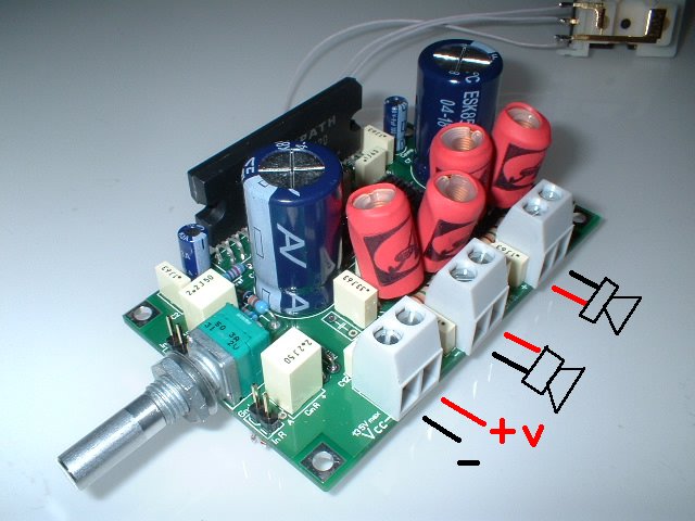

I was searching around on google and came across a TA2020 based amplifier kit. This kit looks pretty good can anyone tell us if its any good, anybody purchased one?
Here are some more screen shots

I actually tried the kit from AudioDigit (I live in Italy) , and it's VERY GOOD!
No problem of RFI interferences at all, and the Alps pot is a good plus, the amplifier is complete.
A friend of mine bought the kits from 41 Hz too, they seem quite good, but the SMD components intimidated him ... and after two months the kits are still to be assembled....
I actually built my kit from Autocostruire in less than an hour, no problems at all. And the sound is fantastic, they say it's due to the air core inductors ... and I'm quite confident they are right.

Thanks for sharing, do you also have a SI T-amp? if so how does it compare?
As regards the sound I can say that it compares quite well. It's a bit more powerful, and the sound is more "delicate", in the sense of a noticeable refinement , expecially on highs.
The most noticeable effect, which really striked me, was the sound of the "tape hiss" on old recordings. The sound of the kit from Autocostruire is really impressing, it's really "true". The same applies to high frequncies in general. I think it's due to the air core inductors, they are said "saturation free" by the description, and of course they don't suffer of the hysteresis curvature as the common ferrite cored ones.
To be short, this new kit in my opinion is really a step further, not to mention the easiness of building and mods.

I saw this new kit and I was wondering if those filter inductors would cause EMI, because they are supposed to block high frequency switching noise.
IMHO donut cored inductors (= 41Hz) should be better for this task, because of the closed magnetic circuit, while open inductors like those in the kit should spread a lot of EMI.
Thank you starn02 for solving this doubt for us!
On the other side, it is sure that air cored inductors don't saturate and this is very nice if you have to run the amp close to the max output power (=undistorted sound until heavy clipping)
Starn, did you use a grounded steel box for the electronics?

I too am concerned about the EMI radiation from the air-cored inductors in the Audiodigit design. However, the Amp3 uses “low permeability iron powder” cored toroids which are supposedly better than standard iron/ferrite and causes less radiation that air-cored. What is the mechanism for EMI to cause actual sound problems does anyone know? Presumably the idea is that some other component is affected and causes some sort of adverse feedback.

I wonder if using a second board for the inductors & taking care of their relative position from each other could be a good thing ?
It will be easy to wire the inductors to the amp. board using good silver plated wire (shielded) and the distance should not matter to much.
What do you think ?

I have never performed measurements or tests on the EMI of the 2020 kit (and neither for the original t-amp), but I had them for a lot of time on my desk without an enclosure between computers and audio equipment .... with NO PROBLEM at all: no noises, no interferences, no stange ripples on the computer screen ...
And all that without an enclosure. They did not show any influence even when sitting one beside the other for comparisons ... so my opinion is that the EMI problem is not so much a problem.
If you use a metallic enclosure then ...
Ah, I forgot one thing.
I don't think it's wise to set the inductors far from the circuit. The board is small (about 80 x 50 mm) and the circuit is optimized for creating very small current loops.
If you take a look at the Tripath web site and read the data sheets you'll see that they underline the imporance of maintaining the components close to che chip, inductors too.... so in my opinion
the kit already comes with a very good solution.
Experimenting is allowed, of course ....

the reason why I mentionned the second board is that when building speakers x-over, it's important to make sure that the big inductors are perpendicular to each other (to prevent interaction). The inductors on the kit are very close and // to each other. When looking at the picture on their web site, we can see that they give a light angle to each inductors. I wonder if they do that to make them a little bit les // :confused:
Another thing that could be done is to solder two inductors on the top and two on the bottom of the board (T, B, T, B). This would not change the small current loop and prevent the possible interraction.
Yes, Itotally agree with starn02: all pcb traces + wiring should be kept to the minimum in order to reduce inductive loops.
output capacitors are the most sensitive components in this respect, chokes are less critical, but I wouldn't put them too far from the chip.
Starn02's experience is interesting, since the chip is supposed to output a lot of noise above 30kHz, and this is to be filtered by the LC couple.
