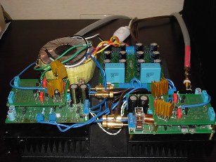

I have finished my 0dB power DB for both channels but no case now.
The dynamic range is HUGE, my tube pre's VR is set at 3
o'clock (maxium 5). :bigeyes:
The picture of the system is here.
0-dB Diamond Buffer for headphone using DT-01 PCB
Compare with modified normal DB-01 headphone Amp ( RIGHT )
0-dB Diamond Buffer has no 1st differential input stage and 2nd VAS,
If add a pair of Power BJT like SANKEN 2SC2922/2SA1216 then it
will be a 0dB-Power-DB for speakers or DB-01 to be a Power Amp.
Plugging this DT-01 0dB DB PCB into the DT-02 Power BJT & protector-ckt PCB then
it will become one channel of my ULTIMA-0dB-Power-DB ! 😀
