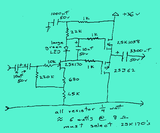

here's my 2 cents towards the simple low feedback approach
Jens, you have started a really hot topic, but as you can read there are no absolute truths.
The easiest approach is probely some local feedback and some global feedback. Local feedback is infact emitter resistors. If you check my designs (which are rather much standard solutions) you can see how I have reduced gain in the input stage and also reduced gain in the second stage. If you have very much reduced "local" gain you get low open-loop gain and therefore easy to feeback globally. To make a totally Non feedback amp is not easy. Check "The End" for inspiration.
http://www.lcaudio.dk/temil.htm
I would say the major problems is the output stage in power amps. There you have the greatest distortion which creates the need for global feedback (unless you design a complex output stage).
Answer to your question: Use sufficient open-loop gain. (But what is that?) 20-40 dB feedback is not too extreme.
