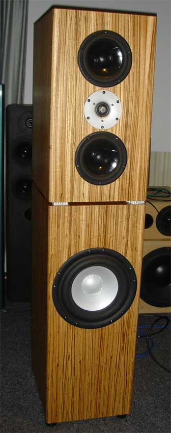

P.S look at the http://www.speakerland.nl/HOT.htm
they use it in an intresting design (see attached file)
I already new that one 😉
The use in that design convinced to use this unit. A cousin of me actually heard that design and raved its fastness and details. And he is critical when it comes to low frequencies.

A small summary of the site:
The maximas are sealed boxes, for bith sub and "monitor" top. Both are braced internally.
The sub is active, with a Hypex submodule (I do not know which one, but I guess it will be a DS series) and the volume of the box is 30 liters.
Total weight is 65 kg, height 120 cm. The top speaker has an efficiency of >90dB.
Because of the enclosed houses, we reach the best impulse behaviour with a real tight and clear bass reproduction.
Imho 30 liters is way too small! Then it should be stuffed with 100% Dacron or something like that, and even then I doubt you will get a real tight bass. But I am picky when it comes to bass 😉
I think the whole system will be very dynamic, despite the closed boxes.
If you want to know more, I think you can always e-mail them. They are probably also willing to share the drawings and XO details, and even their own measurement results!
