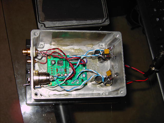

Built one of the 130.00 wonder dacs about a month ago. It is trick, 1545 dac, 8414, blackgates, OS-CON's, NOS, and reclocking.

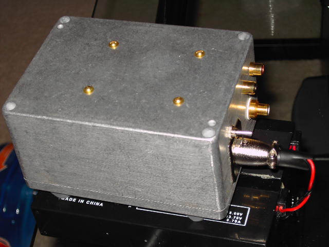

Back End
Since it reclocks I did not bother with a nice data connector. Used a 75 ohm Canare RCA.
Power comes from a pair of 12 volt, 2.3 aH, SLA batteries. One for the dac and the other for the digital circuitry. These were 5.00 each on clearance at Walmart.
The board has 7805 regulators. Not the most elegant way to regulate, but it seems to be fine

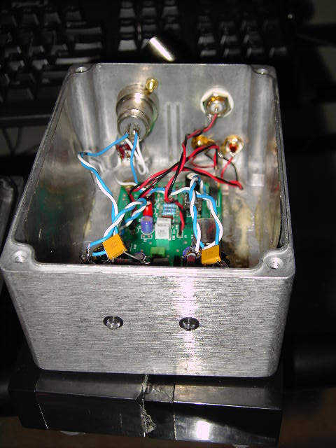

Time Spent
The Monica II board comes assembled and tested. It took about an hour to drill the box, and maybe an hour to wire up. It even arrived with the RCA input and digital input jacks installed.
Had to move a power supply wire and add a ground lead. It came wired for a single supply. But it is designed to be powered by dual supplies. There is an inductor that ties the grounds of the two sections.
The Monica most likely is easier to build. I do not know how the dACK is delivered. The cost is also a little different, 130.00 delivered for the assembled and tested board.
My original plans for a NOS dac was going to run 500.00. I just wanted to try it to see if I liked the results. This ran less than 200.00 including the two SLA batteries to power it.
