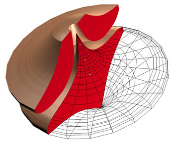

bingo this is what I'm looking for. is it just any exponential "sp?" curve for the deflector or is it made like a horn ? I'm making plasma tweeters and want 360º bass/midbass up to 1.2Khz where the tweet will take over. The plan is to use a 7 or 8in Dayton RS series woofer. iv seen the ones for sale but they don't list specs on the horns, only this pic.

Ummm... is the plasma tweeter direct radiating out of a horn?
The curve of the HF element shown in that cutaway is likely to conform to one of the usual curves (exponential is one).
The Mid driver is likely only getting reflected from the surface that it faces, as there is not going to be much if any compression taking place, and the mouth size is too small to have any effect at LF... I think those speakers may have another woofer for LF, not sure...
it's not clear from that cutaway but the commercial speaker uses an upward firing mid that sits where the wireframe part of the image posted is...

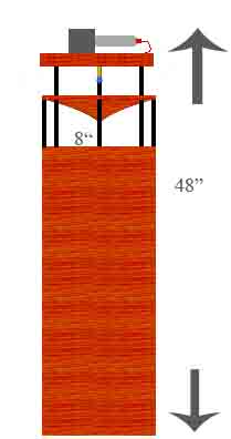

my problem is I want them to look and sound good. I'm going to stack the tweet over the woofer, I know playing into a flat bottom will sound like ****.
the Idea
attachment.php
edit. I think this may be a good time to test out my vacume bagging skills, I will get some HD foam and hot wire it into shape then overlay it with carbon/fiber, kevlar, or CK.

Your rendering/idea looks somewhat like these:
http://www.cd-konzert.de/loudspeaker.htm
This is actually not a new design - there have been several speakers like this on the market over the years. I think it's quite a challenge for the DIYer, with the curved horn surfaces, etc., but I'd sure love to hear the result.
Good luck with your project - I'm sure we'd all like to see what you've come up with when you're finished. Hope the Duevels give you some ideas.
BTW - have you decided on drivers yet, or will that be decided when the concept is more advanced?
