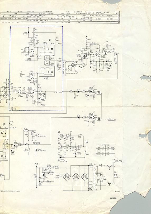

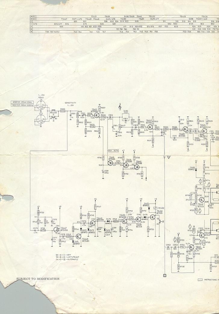

MFB - Part 1/2
Hello Folks!
I think it's time for me to give a contribution of one more schematic for this forum.
I had one of these MFB speakers 25 years ago...Has I remember they have amazing bass.
Here is the schematic of this active speakers from Philips.
Jorge Santos
Re: Re: Mfb
planet10 said:
MFB?
can you expand this TLA for us
Elektor had a project long time ago. They attached a piezo element at the dust cover of the speaker. This sensor reacts on force (pressure). If it's attached at the speaker you will get acceleration as output signal.
Constant acceleration = constant sound pressure level.
The acceleration signal is feed back to a normal regulator (opamp + power amp).
I have tested this myself with a 5" wideband speaker, worked nicely. The sensor was a piezo element from a greeting card.
If you press your thumb on the element you will 50-100 V!
I started also a 12" project but didn't come so far....nothing has happened since 1987...

I've got at least two or three of those old Philips speaker service manuals somewhere around the house. As I recall, they required specially made woofers. How applicable their circuits would be to DIY efforts is questionable. Again, from memory, they seemed more complicated than necessary.
