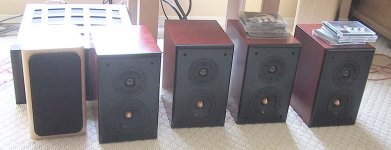

Little guys... HT 1 (hard to see the WR125S + RAW ribbon behind the grills (more on grills later), next 4 are 2 renditions of WR125S + HiVi tweeter. One lets the WR run FR, the other a more convential 2-way. excepting the FR125 (in the same parts express box) the former had the best mids & showed off the WR125 to its best.
(note: many of the pictures are problematic from huge light coming in thru the window into the darker room)

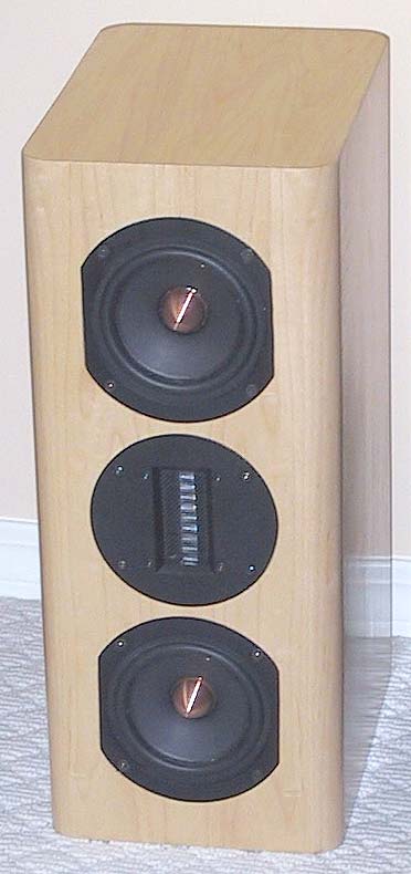

HT 2 MTM WR125 + ribbon... all the HTs seemed to me to trade measured FR off against dynamics & livlieness ... still these were good (within the context of the aforementioned note), and some day i hope to get the opportunity to give them a better audition under known conditions.

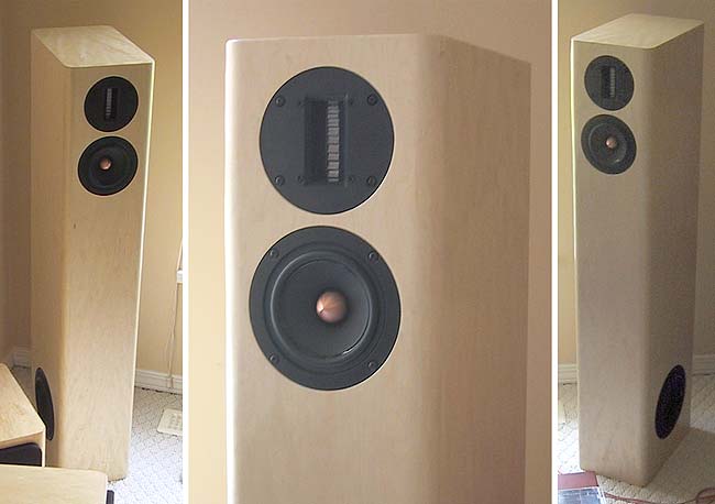

HT 3 -- an MT up top with WR + ribbon, and an extremis low down on the side crossed qite low. Other than the performance given by the FR125, this was the best speaker of the day, possibly partially due to the placement of the extremis being much better matched for the room. This speaker has a lot of possibilities, not the least of which would be an active option on the bottom (there are some pretty big reactive components at the 110 Hz XO point that would go a ways to paying for a little plate amp)

With their svelte front profile, the heavily rounded front corners, the excellent veneer work, and the lovely copper phase plugs, all the HT series are a really pretty speaker. The grills (more on the grills) were even cool.

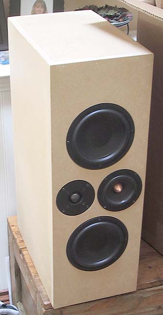

This would be considered the big daddy. Called the LCR -- can be oriented as shown or rotated for convential centre channel duty. The 2 extremis on this overloaded the room severely and made it impossibly to give them a decent sonic evaluation. The tweeter is an Usher.
