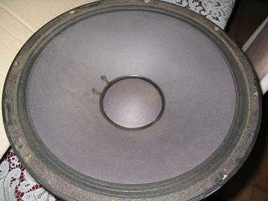

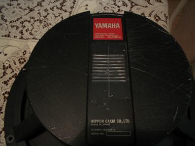

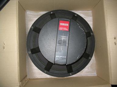

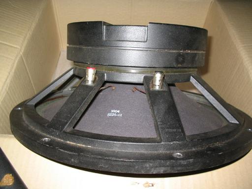

Help needed with these drivers. I have 4 of the ja 3882b drivers. They are massively built and look like they could survive armageddon :eek:
My problem is the datasheet and the T/S params. The sheet came from Yamaha so it is in Japanese, the sheet lists the Qts as 0.13 with a fo of 30Hz. As far as i can tell the vas is 300litres sensitivity is 102dB.
Big question, how do i lower the qts to make this driver easier to work with ? Getting bass from them is proving to be very hard.
RE 3882b
oops, i meant raise qts .
these little buggers were running in some rather large mid horns. 100-2500 Hz
The beer midget wanted her house back so, i am now left with four of them. (drivers not beer midgets)
The data sheet is a pdf, i have no idea how to put these on the page.
The pics are of the driver in question, they make my jbl's look lightweight. In a horn these are exceptional, powerhandling and compression is not an issue.
