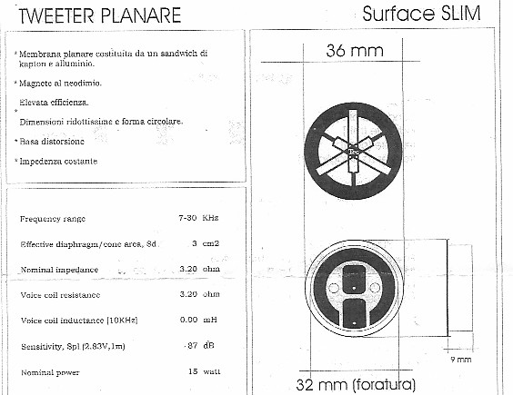

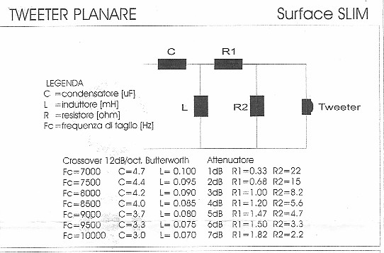

I also attached factory information about recommended crossover and values for the Surface Slim.

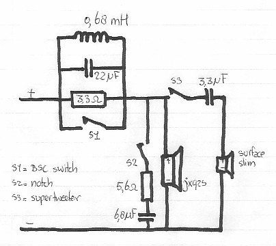

My BSC
The switches are for expirimental use only.
The BSC just softens the middle a bit, but not too much.
The notch reduces the high, but levels the high and I think it gives a better quality of high freq. It also makes the BSC more efficiënt. Without the Surface Slim I switched it off, with the Surfase Slim it is on again.
I am thinking of change the 3.3 cap for the Surface Slim for a bigger one to kick in earlyer. I do not know when it kicks in, but I think not before 15kHz. Maybe someone can calculate it?

Just the BSC without the supertweeter, you will get around 12db loss at 20K. Since the acoustic characteristic for the tweeter is not clear, and the impedance curve is not available. The only way to to calculation is by actually testing the driver first.
I think he wanted to change the 3,3uF to 5uF to lower the x-over for the tweeter.
