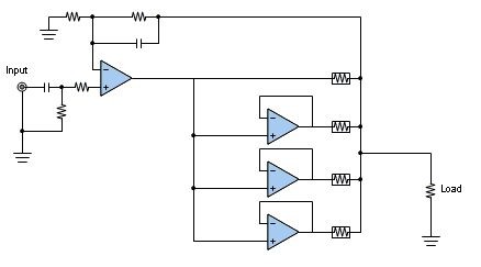

Ok, I don't quite follow your line of thinking, but basically what I suggested above entails enclosing the parallel amp inside the feedback loop of an opamp. (see attachment). Each individual amp in the parallel amp still has its own output (load-sharing) resistor, and these absolutely must be outside of each chip's feedback loop.
In the attached schematic I have drawn a simplified four-way parallel amp inside the feedback loop of an opamp so that you can get the idea.
Discalimers: This is intended to be representative only and is not a tested design. There are no component values; you will have to choose them appropriately. Most of the National chips are stable at gains of 10 or higher, so set the gains appropriately, and match them very closely. Also note that the overal gain for the input opamp loop must be greater than the gain for the chipamps, even if the opamp is unity-gain stable. As drawn, the circuit probably has some nasty DC offset problems (especially with all the + inputs of the chipamps all tied directly together), and I would personally take extra steps to reduce DC offset.
[/i]
I agreed with macboy. In addition, I would add Cap in the feedback to ensure unity gain of each chip. Also, individual zobel of each chip will be helpful.
Good luck,
the outer loop op amp has to be slower than the paralleled output op amps - not hard when you're using 100 MHz cf amps inside
a gain of +2 in the output amps makes for easy R matching and doesn't amplify offset too much
load C isolation may still need attention, but a high frequency lossy ferrite or the usual load isolating resistor+inductor (outside the feedback loop!) should work

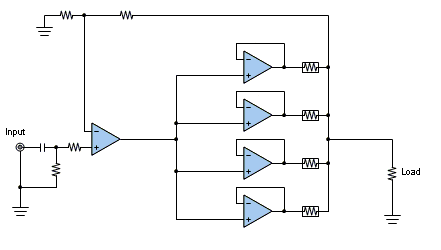

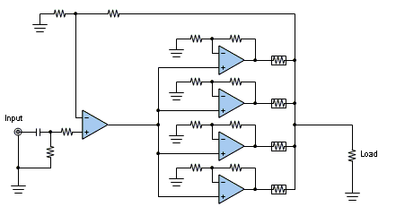

What about something like this: similar to macboy's schematic. Using paralleled amps at unity gain inside the feedback loop of an opamp. Would the paralleled amps still need output resistors?
Yes. But you can get away with small ones, like 0.1 or even 0.05 ohms.
Be very aware that this can only be done if the amps that are used are unity-gain stable. (I only mention this because the National LMxxxx chip amps are not, and I just know that someone will wonder if it can be done with them. Answer: No.).
If you are going to use unity-gain stable amps, then you can hook it all up like the following, and eliminate the extra opamp on the input. Note all four opamps in the schematic are identical power opamps. (also note that this schematic generally assumes voltage-feedback opamps. With current-feedback opamps, you can't use the cap across the feedback resistor, and you can't configure it for unity gain by tying the output to '-' input).
