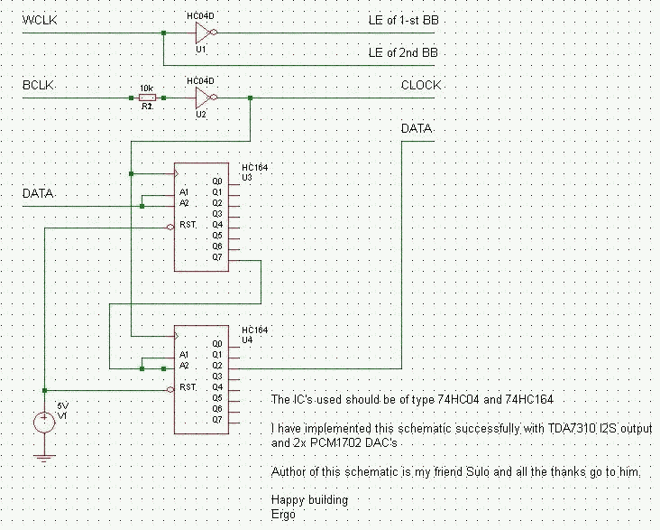

NON-OS AD1865 DAC
Hi Peter,
If you want to implement the AD1865 in the CD-PRO you do need glue logic. I am not so happy with AD application note. The most simple circuit; minimal component count; is with a shift register. 74HC164.
If you wish to construct a separate DAC component you could use the CS8412. The latter chip can be put in mode 6, 18 bits output mode and you only need a inverter to get a inverted LATCH signal.
After much experimenting I gave up the idea of a balanced DAC with the AD1865N-K, simply because it sounds better non-balanced. Also found that of the two methods to get separation into left and right audiochannnel: stopped clock technique and inverted LATCH; the latter gave the better sound. I did not hear the time difference or delay between the channels that is obvious with inverted LATCH.🙂
I wouldn't like to use CS8412 (although I have one), because in my opinion the whole advantage is to use I2S interface and feed it directly to the DAC. Best sound, is what they say.😉
As to PCM1702, I've built already a DAC implementing parallel 1704 chips, using Dave's board. The sound beats my air bearing TT.😉
The circuit posted does not address the interchannel delay and a balanced dac built without addressing the interchannel delay is unlikely to perform at its best. If the stopped clock method of addressing said delay is not to your liking, one can always go down the large shift register route keeping the continuous bitclock.
ray.
Interesting schematic.
But maybe I'm not seeing it correctly.
Looks like you are shifting SDATA 16 bits (2X 74HC164) so that the left channel's LSB and down-going edge of the inverted LATCH coincide. From the above I assume that it is for use with 16 bit I2S. I do believe there is a 24 bit variant, too.
But the AD1865 has an 18 bit input.
Won't the AD1865 still accept the last 2 LSBs intended for the opposite channel and add them above the MSB of the channel before the LATCH is enabled?
Don't you have to stuff an extra 2 LSBs for each channel, in there somewhere, so the 1865 has an 18 bit input register full of good 16 bit data? 😕

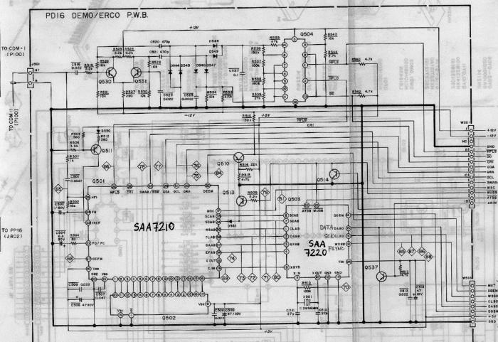

Here is a filter board of my Marantz CD94 player. It uses Philips SAA7220 digital oversampling filter. If I would like to implement non-oversampling mode on 1541 DAC can I just omit SAA7220 and take signal directly from SAA7210 chip? If yes, which pins then?

NON-OS DAC
Hi Peter,
See for example:
http://members.xoom.virgilio.it/hi_fi/com.htm and
http://members.xoom.virgilio.it/hi_fi/cd960.htm
<B>AND</B>: ( this applies to the Philips CD960 that uses the same IC's.)
Modidification to NON-Oversampling including installation of KWAK-CLOCK [version with single supply]
Color codes of wires of KWAK-CLOCK:
Red = +5V
Green= ground
Blue= clock output of KWAK-CLOCK
Remove/desolder C511; C512 & X501 (11.2896 Mhz crystal) All are on board
PD16; the board with the large IC SAA7220 (Q503); just near this IC.
Solder 11.2896 MHz crystal to KWAK-CLOCK PCB.
Connect the green wire of the KWAK-CLOCK to the negative side of C514.
Remove /desolder entire IC SAA7220 (Q503) 24 pins.
Connect the red wire to pad of pin# 24 of IC SAA7220 (Q503)
Connect blue wire to pad of pin# 9 of IC SAA7220.
With a piece of insulated wire connect pad of pin # 1 with pad of pin# 18 of IC SAA7220.
Same for pad of pin# 2 with pin# 16.
Same for pin# 3 to pin# 15 .
Please note these instructions are different from Marco Amboldi's as no tracks are cut in my modification making the modification reversible, not permanent.
Also note that with the latter modification the digital ouput is lost. You can not use a outboard DAC component. The KWAK-CLOCK output is directly connected to pin 26 of SAA7210 (digital signal processor)
