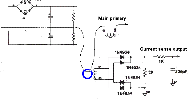

No, You can not use resistor at this topology, because both sides of primary are floating... You need a current transformer, but it's not a big deal - just 50 turns of wire on 10-15mm ferrite toroid core for secondary. and for primary 1 turn - just pass "cold" side of primary via the core. You can find a lot of such tr-rs in old SMPS. The secondary should be connected to bridge (4x1N4148) and 20 Ohm load - it will provide (Iout/50 )*20= 400mV/A. Additional R-C filter is desired to remove overshoots.

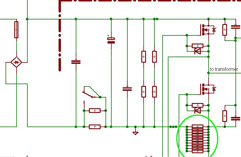

However, I still don't understand what's the problem with a sense resistor. I assume that it will only "read" current half cycle, when the lower mosfet is on.
My proposal is to put the resistor from the low side mosfet source to gnd.
Shouldn't this be enough for rough overload protection? It worked very well for me in a Class-D power amplifier.

The problem with resistor current sensing arises from its lack of mains isolation except when the control circuit is already on the mains side
Current-transformer sensing solves the issolation issue
Also remember that asymetric pulse-by-pulse current limiting drives the transformer into saturation and destroys the switches. Inmediate shutdown is required to avoid that

You can use it for average-power overload protection, in such case it's better to place Your sensor in the negative rail of the H-bridge, but in Your 1st post You asked about cycle-by-cycle current control - in this case You have use current tr-r, because You can't control 3525 with low-side pulses only.
If average-power protection is enough for You (it's slow and not so reliable) - to my opinion You can't use 3525 built-in protection as-is (in overcurrent mode output pulses can get very asymmetric) - You will need to design some trigger-like protection mechanism with LM393 etc.,
if it DIY project and not mass-production - take 20 minutes and wind 50 turns 🙂...

adding to Eva's comments, it also gives only "half" the picture, as you will only be sensing the current through the lower MOSFET, and not through both. You need to sense the current through both MOSFETs or you will end up with an imbalance, leading to "walking' of the core toward saturation, and destroying one or both MOSFETs in the process.
BTW, even though you are using the SG3525 voltage-mode chip, you can implement a crude cycle-by-cycle current limiting by taking the output from the current-sensing transformer to a signal-conditioning op-amp and then on to pin 10 (SHUTDOWN) of the 3525. Whenever the output from the op-amp exceeds pin 10's threshhold (which, I believe, is 1.0V), if the duration is short enough, the SS capacitor will not discharge enough to trigger a new softstart cycle, enabling you to realize cycle-by-cycle current limiting this way.

The picture is cut below the current sense resistors. I thought you were trying to show us how the current limiting is done, not only the sense resistors. Your arrangement is just how I was proposing: source of the low side mosfet to GND. But, what are you doing with that signal?
Pierre
Oh, sorry. I thought there was some kind of technical problem with the picture.
Here's the current limiting part of my schematic, but ths is now only a schematic, ha couldn't test the circuit, becouse of my exams. I'm an Electrical Engineer student... 🙂
I know, there should be one or more capacitors near R8 R33. This/theese capacitor(s) will be determined by experiments.
here's the schematic: http://sziget.mine.nu/~danko/aramkor/testbed/9/current_sensing2.jpg
I turned off the part's values, becouse with the values, the picture would be very caotic...
(I have removed the previous pic from my server, becouse that's also uploaded to the forum)
