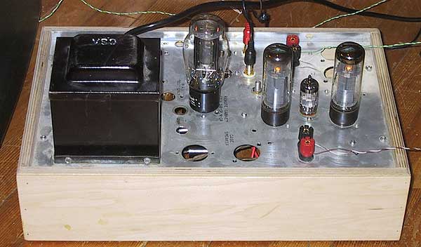

Dave, for fun why not post a picture of the RH34 (no upksirts tho, it's not too pretty under there right now)
Even with 6DJ8 driver quite wonderful, and after the experience with parallel feed EL84 / EF86 drivers, I can't wait to try the same with '34's: put those Mullards to the test, that's for sure.
I might have to split this last bit into a new thread... since it has morphed into, used tube kit, second life....
Here is the proto RH34. The chassis plate, power trafo, and choke (underneath) were from an Organ, the OPTs from an east german EL84 amp (the largest EL84 OPTs i've ever seen... the 2 sections wired in series instead of parallel made them suitable for EL34), Mullard EL34s from a Dyna ST70. input tube recycled as well as as many other parts as we could easily find. We did buy new Solen fast caps for the power supply....
dave

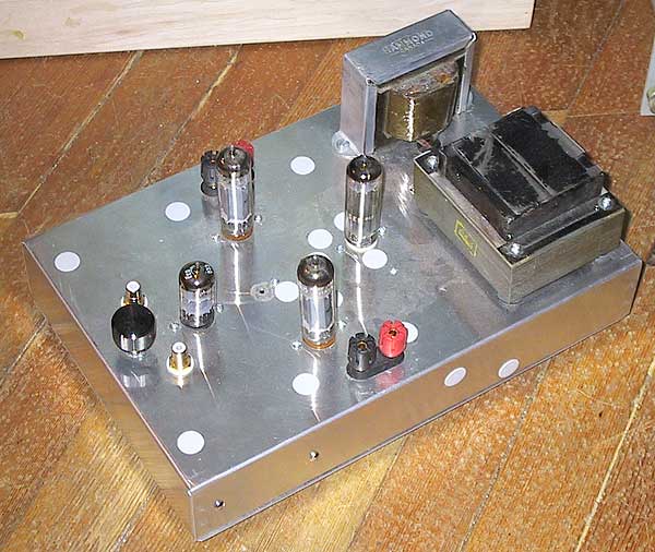

And my RH84... this was Chris' 2nd chassis (rev 4 or 5) on his journey to the RH84 parafeed monobloks he has now (same chassis but 2 of them). I just needed to add a set of OPTs (from a Magnavox) and a power trafo (from a Grundig). Choke from who knows where.
dave

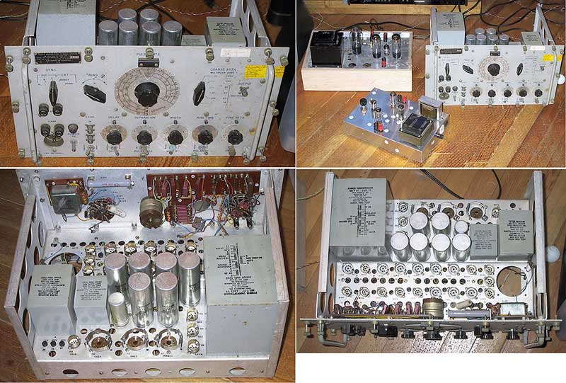

And the major donor for a PP RH84... i was looking at this as a transformer donor for the #2 RH34 but decided it would be a shame to separate the trafo from the chokes... and if that why not recycle the chassis. With all the 9 & 7 & octal sockets all i have to do is remove stuff to get the basic layout. Tridoe strapped 6AU6 for the front end (i can generate a matched quad of those out of my tube stash, something not possible with EF86s -- triode strapped 6AU6 was suggested as a sleeper by Bill @ PEARL). The trafo has 2 high voltage windings (450-0-450 & 175-0-175) with a choke for each so it will have separate supply for drivers + screens & outputs. I'll get a nice piece of plexi machined to replace the existing front panel.
dave

What i'm really interested in is an RH-style Class A PP amp... scoping out a chassis for an EL84 one last night (repurposing a military radio transmitter).
