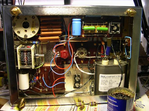

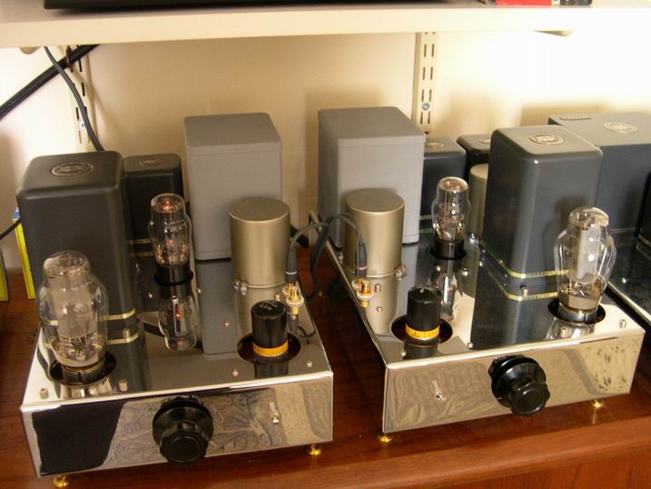

Same thought came to me several months ago for a 300B line pre in order to drive my 845 monoblocks.The idea was to built a whole DHT system,from the beginning all way to the end.I wonder,what would be the sound of a projeckt like this after building preamplifiers with ECL-86,5687 and currently 6BX7.
300B is one of the most linear tubes has been ever made,it's a DHT,and as they say, the sound or the colouration of a stage is infected by the earlier stage.
An interesting approach is here,
http://www10.big.or.jp/~dh/work/93072.html ,which I thought to modify.
Anyway,I'm looking forward to seen the outcome of your search
In my case the best result i had with C3m tubes (I used transformer input 845 power amps).I use local feedback in gane stage.
This is best preamp for my Power amps.
Iam very sorry for my Inglish🙄
