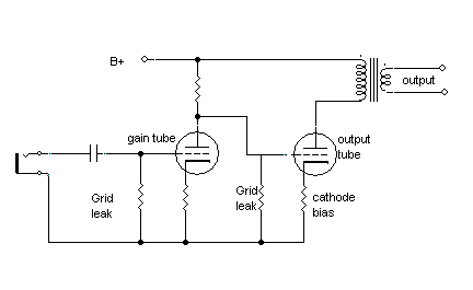

a real basic 2 tube SE mono deal should be very easy to do from scratch. ( I mean, youve got two tubes.. ~5 resistors.. a couple caps. two transformers. some filter caps and a tube or SS rectifier.)
I'll attatch a pic of the BASIC design of most SE amps (bare minimum deal.)
output from gain tube

If the output from the gain tube is positive and is used as the control grid input to the output tube, how does it become negative thereby resisting the electron flow from the (negative) cathode?
I am certainly missing something here. I know it works, but how?\

ok.. I'm not super good at this, but I'll try to explain it.
ooops.. forgot a coupling cap between the two tubes in the scheme.
anyways, in theory the grid has 0v DC on it. (and of course an AC signal [the audio]).
when the tube is in operation, with cathode/self bias (this configuration [the cathode resistor]) the cathode becomes positive! (for example we'll use say it's +10v. it really depends on the tube and resistor though.)
so if the cathode is +10v, and the grid is 0v, the grid IS negative in respect to the cathode!
neat huh? 😀

Colt is correct with his explanation of the cathode biassing arrangement for the output tube, and also that you need a cap between the plate of the driver (gain) tube and the grid of the o/p tube.

OK, I'll take a shot at this, though I think others may be better able to explain it than me. I've only got a rudimentary understanding of things. Others please correct any mistakes!
>>I did print out and read NC's part 1 and still not getting it...<<
What specifically about it are you not "getting"?
>>The AC signal (audio) is going + and -, thereby attracting electrons (increasing current to the anode) and repelling (decreasing current to the anode)?<<
In a sense this is correct. Reality is that the grid is always repelling electrons in "normal" class A operation. If the grid goes more positive than the cathode you have class A2 operation. There are valves designed for this, but typical receiving valves (the sort most frequently used) are not. There are a few commonly used exceptions. The 211 is one.
>>AC signal can be + as long as it is more negative than cathode?<<
Yes, unless you want class A2 operation.
>>Is the AC signal always repelling the cathode to anode flow?<<
Yes, sort of. The AC signal on the grid does the repelling. See above.
>>Then at the anode, it has a fluctuating DC that has to pass the coupling cap to the output tube? How? Caps stop DC?<<
Yes, the cap blocks DC and allows the AC signal to pass. The cap must be of a certain minimum size to pass all audio frequencies. This depends on other circuit values.
>>There must be an AC signal out of the gain tube?<<
The fluctuating DC voltage is across the load resistor of the gain tube. The way I look at it is this: The tube is a variable resistor controlled by the grid - cathode voltage. This variable resistor forms a voltage divider with the load resistor. The power supply supplies a fixed (theoretically) voltage to the top of the voltage divider. When the grid is made more negative less current flows making the tube seem like a big value resistor. When the grid is made less negative more current flows making the tube seem like a small value resistor. If you think about the way a voltage divider works (the voltage drop across each resistor is proportional to the size of the resistor) you can see that the voltage across the fixed load resistor will vary with the input signal on the grid of the tube.
Hope that made at least a little sense!

Should I start the design at the gain tube by drawing loadlines, etc? Or, get a proven schematic and review design, check adequacy, etc? Or, start at the speaker end and work backwards?
Start at the output and work back. If you don't already have it, get the WE 300B datasheet from http://www.westernelectric.com/spec_sheets/300B.pdf
At the bottom of page 5 you'll see a chart that shows the relationship between load impedance (transformer primary Z), distortion and power for a given bias. The same basic relationships hold for most tubes. At at Z=3000R, Pout=8W. 2500R - 3500R seems to be the most common range of load impedance for SE 300Bs, so we know it works.
For the excercise, lets use the WE parameters. They designed the tube and probably had the brightest collection of tube engineers and knowledge ever, so I assume they knew what they're doing.
Vp-k (Eb) = 350V
Vg (Ec) = -74V so Vp = 424V
Ip = 60mA
Pd = 21W
With a dissipation of 21W (36W rating) it's a conservative op point, and will give long life. Anecdotally the best sound/tube life compromise seems to be at 80% max, or 28.8W, so there is still some room to get a bit more power. Many good amps use a similar op point.
Plot the loadline if you like on the WE graph on the top graph on p3. Play with some different points until you get a 'feel' for what's happening.
Steve Bench's page at http://members.aol.com/sbench102/po-dis.html gives more loadline data.
