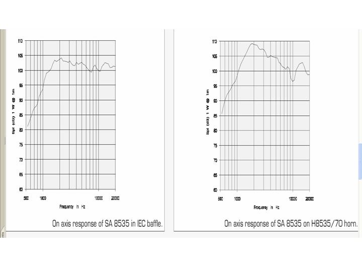

The SAE 8535 planar is one of the most efficient drivers. I've attached the SPL plot with, and without the compact horn. About $550
The Magnepan tweeter ribbon uses 2.5 micron thick aluminum. This is the thinnest I have seen. I have some and I can rip it with a strong breath. A 1T gap field with 2.5u AL over 81" x 0.25" will produce SPL close to 105db/meter at 1 watt. I have used 4u and 5.8u foils, and found 5.8u the thinnest that was robust enough to survive.
DUDE, you just got to drop $2K-$3K on grade 50 NdFeB magnets and 300 lbs of iron. Don't forget stainless steel tools and vises. Don't crush your fingers or erase all your disk drives and tapes.
you have a link to that SAE planar?? also what did they do to make it so efficent?
