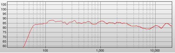

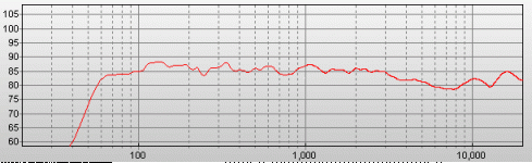

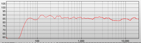

In the FR plot (3rd octave smoothed) you can see it going low enough for its tiny drivers and only 3 litres cabinet. The TBs exibit deep recession in the presence range when in an unfiltered bipole, so I had to keep that to a minimum by using a sloping response with fatty low-mids and a finally acceptable -2.5dB recession in the presence range. This is about a Harbeth BBC LS35/A type of balance. Polite enough, transparent, and full.

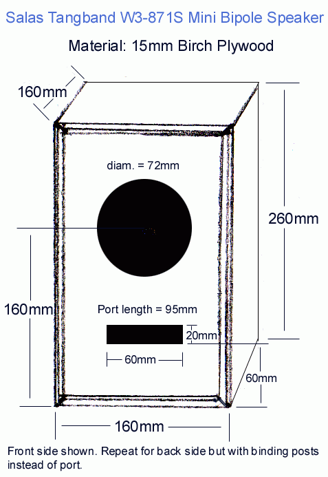

Please refer to the attached images for the cabinet drawing, notch filter and FR plot. The bass reflex slot I use is aluminum made but you can make it from little wooden panels or even convert it to a tube with 10-12sqcm mouth. Just keep the depth 9,5cm. Just use wool felt on the inside walls. Only one pad per side, top and bottom.

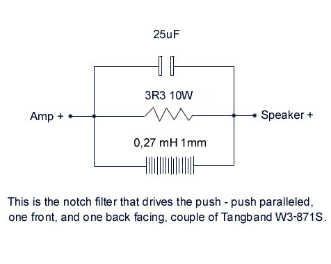

You can combine a MKT 15uf cap and a Poly 10uf cap in parallel to get the 25uf notch filter cap. This saves cost, and the better 10Uf cap dominates sonically.
A 10W MOX or other low inductance resistor is worthwile along an aircore coil of no less than 1mm wire. More is better.

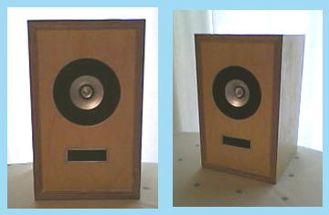

All in all I am quite pleased with this mini and I recommend you try it in situations where budget and space is not sufficient for bigger projects.
I hope that by next month I will be contributing a new bipole design (floorstanding column) with a very nice 4'' Euro driver that looks quite promissing for quality and good sensitivity. In the meantime I have to photograph this TB mini one I guess and post it here. It looks pleasing enough too 🙂

Speaker was facing 5m to front wall, open balcony to the world at the back, side walls were at 1,5m and 2,5m.
Mic @ 1.5m. MLS window 180ms. Checked the bass extention with 3 calibrated mics.
Yes it can be heard also. No big pressure but the 50hz region can be followed quite easily by ear when playing music. It did not detract much from same closed box power handling.

The FR plot is with notch filter, I will post a sans filter one during the day (P10)

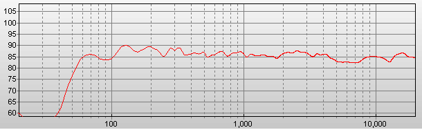

For planet 10 I attach the raw bipole response normalised to 85db (there is excess midbass to mid output I kill with the notch to get mid-high up).
As you see it really goes that down, but the Tangbands are not ok for a bipole without a notch. Such a waste of sensitivity...

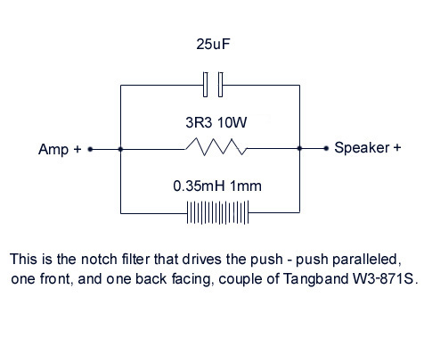

After changing some cables and positions, I settled on a rather more universal coil value for the notch. Please consider this as the starting point.
