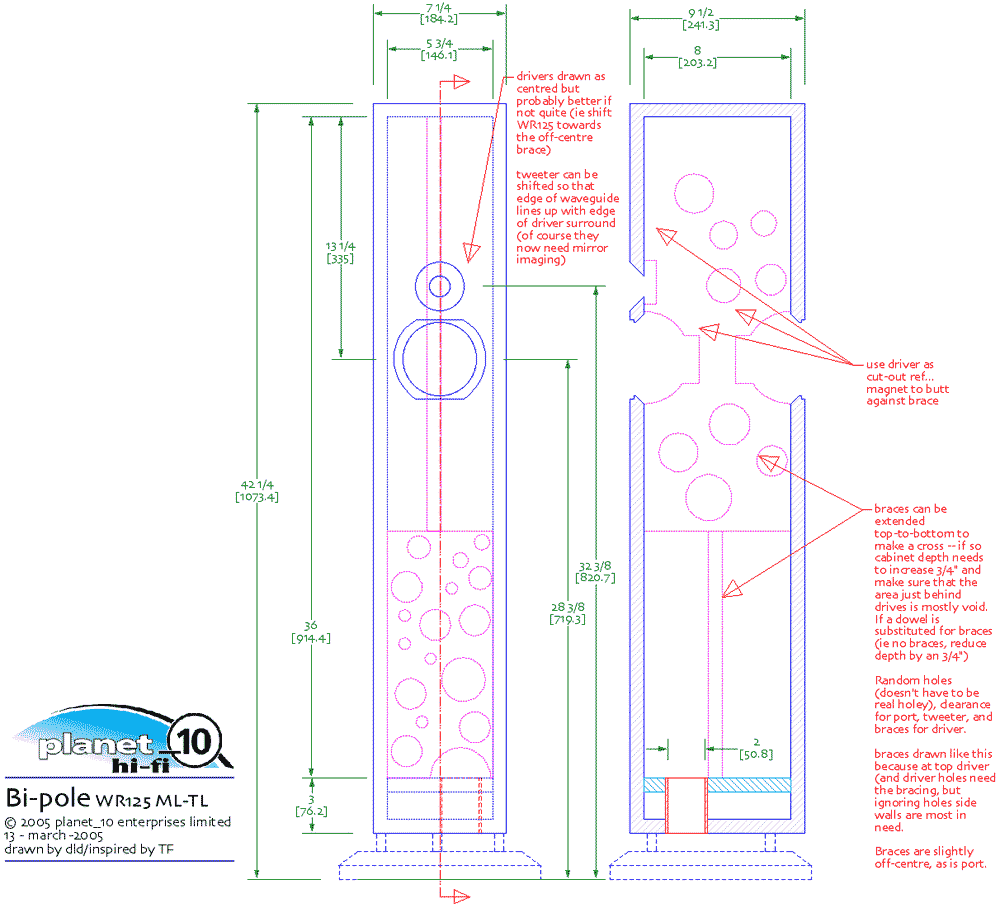

Here is a bi-pole version that i drew up -- Scott is still building the prototype...
dave

Just a comment on the WR125 designs i have heard... in each and every case the more larer the role of the tweeter the less engaging the speaker sounded... the sample was limited to some early designs at the last RAW-fest, but i would be very cautious when doing a design that puts anything between the amps & the WR125. You may end up with a speaker that measures flatter, but it may not sound as good... FR is only one facet of making an engaging speaker ... in many a case pursuing flat FR as an end in itself leads to a sterile speaker.
dave

I'm looking forward to hearing it. This may be the best solution. Despite what some think of bipole speakers I've found them to be extraordinary when done correctly. My RS 40-1197 versions are still in regular use. My wife loves opera and the bipole 40-1197 reproduces the vocals in a very special way.
Bipoles
I am with you on that one Tim. I have made two sets of bipoles and absolutely love them both. You designed both of them and they seem to fit just right in my listening room. I really do hope to get into the shop tonight and Sunday to make some phase plugs and at least get a start on the 125st bipoles. I have some lovely lumber to work with. Based on the results I have from your other designs I am going to take a chance and go straight to a finished cabinet. Some how a nice looking cabinet seems to sound better? I hope to have something to take down to Victoria in June for Dave to enjoy.
