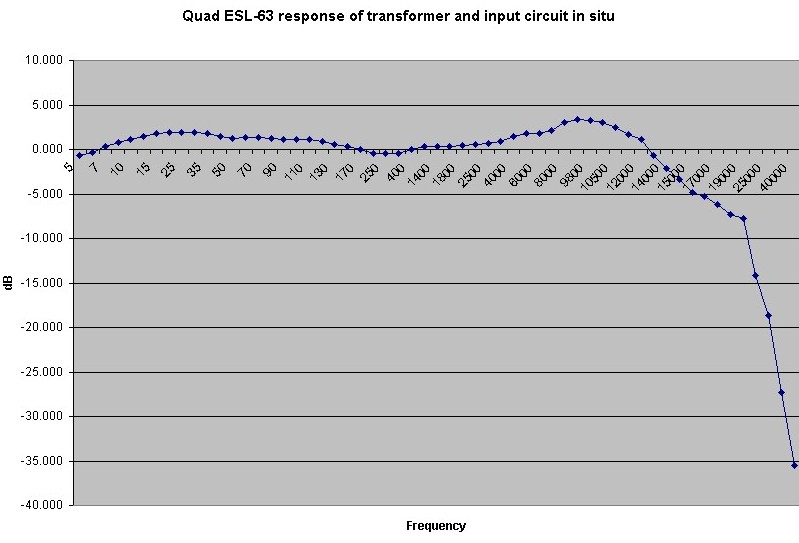

for a directly coupled amp running an ESL you'll need EQ in the amp to get a flat response. If you look at the Acoustat X design (not a bad place to start) you'll find the EQ.
For most panel ESLs this is quite true. As the wavelength shrinks compared to the panel dimensions, beaming causes a treble rise and something has to be done about that. At the bottom end you have to deal with the panel resonance(s) and dipole cancellation. These can be handled by low-level circuits before the direct drive amp, at least in theory.
But the situation is different for the Quad ESL-63 and its newer relatives. Most of the frequency response shaping has been done in the panels themselves by adjusting annular ring dimensions and in the careful design of the delay lines which also act as low pass filters for the outer rings. Take a look at the attached response curve I measured from the input terminals to the transformer secondaries (which are also the inputs to the HV delay lines). This is NOT the Quad’s total response to the air – just what the input circuits (mainly the step-up transformers) are doing to the signal before the panels see it. While it is not perfectly flat, I wouldn’t characterize it as EQ either, or at least not much compared to what has to be done for regular panel systems. The response curve shows a rise broadly centered around 10 KHz, but then a rapid fall-off in the upper octave and beyond. The bass response extends smoothly down to infra-bass frequencies with just a gentle rise. These effects are audible in the stock speaker but correspond, in my opinion, to two slight weaknesses, minor as they are compared to most other speakers.
So you can just connect a direct drive amp to the delay lines without the need for any EQ. What you get (assuming the DD amps are flat, as mine are) is the removal of the attached response curve. In other words, the response at 10 KHz is reduced, but the upper octave and beyond is restored (think SACDs). Also, the bass is tightened a dB or two. I think both of these are improvements to the stock speaker. The treble is now very smooth and airy. The bass end has a welcome tightening, but full bass balance remains. For cleanest treble, I run my Quads “naked”, but that’s another story…
You're assuming that the network going to the 63's panel provides a flat output for a flat input - I am not so sure of that. Any resistors or caps in the circuit? DCR from the coils?
According to Walker's teaching, the response you get is a function of the reactive impedance of the ESL vs. the source impedance of the thing driving it. You can match to different reactances vs. frequency and get a variation in output vs. bandwidth.
Thus the Strickland patent and the Audiostatic Euro patent which seek to provide two points of matching impedance from a nominally single source yielding a nominally flat, wide bandwidth result with reasonable efficiency.
At least that's how I recall it...
Not at all. The whole network is anything BUT flat.
In the case of stock Quads, think of there being two cascaded “black boxes”. The first box includes the input blocking capacitor, series resistors, the protection circuit and the step-up transformers including all the transformers’ leakage reactances and resistances in this one “black box”. The second black box has all the delay line impedances as well as the panels’ impedances factored into its input impedance. Where the first box connects to the second box is where I made the measurement shown in the chart, and also where I connect my DD amp. All the effects of the output impedance of box 1 interacting with the input impedance of box 2 are already captured in the chart response. So if you delete box 1 and replace it with a voltage source (the new DD amp) you will get a system response like the stock unit MINUS the response shown in the chart, no more and no less, because the impedances were already factored in. So the new system reduces the original 10 KHz bump, etc. And that’s exactly what did happen.
My original point was only that box 1 has mild effects on the response and really couldn’t be considered to have EQ like you might see in other ESLs. The significant shaping is done in Box 2 electrically and acoustically. This makes it possible to directly drive Box 2 with no EQ required in the amp.
