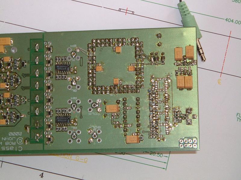

Hi Bruno,
Hate to disappoint, but your approach of using a ADC and feeding a 1 Bit DataStream back into the PWM digital modulator, has already been done – Rob Watts & I did back in early 2000 – and I’m sure others have done so earlier – its also Public domain as I demonstrated to many companies,
Below is a board I constructed using a FPGA as the modulator, ADC with an external 4th order loop.
It was complicated – but the sonic footprint of the ADC was always an issue – and did not qualify as a pure digital amplifier by my definition – measured performance was very good – only really needing a 3rd order loop around the ADC.
Below a picture of the only PCB I here in my lab in CZ (other exist somewhere), the DAC and Integrator OPAMP’s have since been removed…. The date on the PCB is 2000…..
John
The underside of PCB showing the 4th order intergrater opamps (4 + 1 summer) beside the "DAC" - the FPGA logic input threshold was used as the 1 bit quantizer.
Also "PCB" Set / Reset Pulse Transformers for the all Nch output stage....
John
It's often said that ideas spring up independently in different people at roughly the same time.
I first started work on this in 1999, but never finished because the company was always "just interested enough" to keep us from selling it to outside parties but not interested enough to pay for the development. Further, the first attempt at writing a patent got botched by the patent attorney who reported that he "nearly understood the story, but would like to know what 'z' meant".
We had a second go in 2003.
I've got no idea what sound quality to expect from this, except that it's be the loop DAC determining the sound, mainly.
What I don't get is what you needed a 4th order loop around the ADC for. I had mine running at 768fs (=same as the modulator clock frequency. PWM frequency = 8fs) and 2nd order was more than enough for that. If you have a 4th order analog loop you lose the chip area advantage, and it really becomes more sensible to use that very same 4th order loop for the amp itself, and use the DAC, well, as DAC (as per your current approach).
From this difference in ADC design I suspect that there must be a few other differences between your work then and mine as well. If you could elaborate.
Hi Bruno,
I should have said 4th order to form the ADC….. Yep your correct 2nd order would probably have been enough, As I said earlier, in the end I used 3rd – to insure some correction “headroom” – the PCB was designed before I had any real idea how much correction I would need… hey, could have designed to 6th…..
It’s a long time since I worked in this method – I seem to recall the PWM Fs was about 1.5MHz – 2MHz to be above the AM band!!! Still the dissipation was not too bad – not too good :hot:
Later designs used reduced PWM clock rates…. Have to learn somehow….
Shame we did not know of each other back then – could have made a great team!
Hey, our modulator also operated at 768fs!!! parts of this early development became the Zetex ZXCW6100/8100 modulator (which has "un-published" modes and interface that would have linked to a second "analogue" driver / FB chip incorporating the integrators etc. That’s why the ZXCW6100 operates at such a high clock rate…… it was not really designed as a “stand alone” modulator – needed its companion….
John
