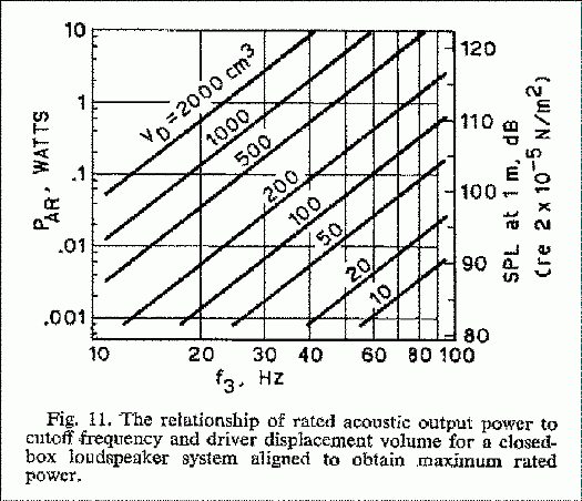

The following is the chart for how much air must be moved to produce which SPL @ 1Meter/1Watt. For most rooms, the 1Meter/1Watt figure will be reasonably uniform throughout the room.
These figures apply for under 100 Hz. You can extrapolate for above 100 Hz as well. However, below 100 Hz is where displacements become critical.
Remember, these numbers apply to Sealed Systems only!. A Bass Reflex system can produce up to 12 dB higher SPL for the volume displacements listed here.
Interestingly, these volume displacements will apply to the Drone Cone, (Passive Radiator) displacements as well. Not the driven speaker-the displacement of the Drone Cone itself.
This chart is taken from Richard Small, (of Thiele-Small fame), Analysis Of Closed Box Loudspeaker Systems
Part 1: Analysis
Published in the Journal Of The Audio Engineering Society in 1971, (I think it was 1971).

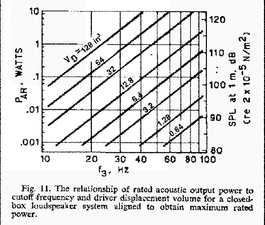

There are two charts. The first is in normal measurements, the second is in metric.
Enjoy. I think everyone will find these useful.
The whole chart fits on your screen if you press F11, assuming you use Windows.
And hats off to Richard Small for making such a useful chart, among so many other things! 🙂 🙂

Here is the chart in normal measurements.

PS:
Volume dispolacement is calculated by multiplying Cone Area, (Sd) times maximum excursion, (Xmax).
Please note that these charts are calculated using Xmax that is plus or minus. If your Xmax is listed as front-to-back, divide by 2 to use the values on this chart.
One way to calculate cone excursion is take the length of the voice coil, (VcL), subtract the height of the air gap, or gap length, and divide by 2. For instance, if your voice coil is 1" long and your gap height is 0.2", then your Xmax is .40".
Example: [ (1"-0.2")/2 ] = .40"

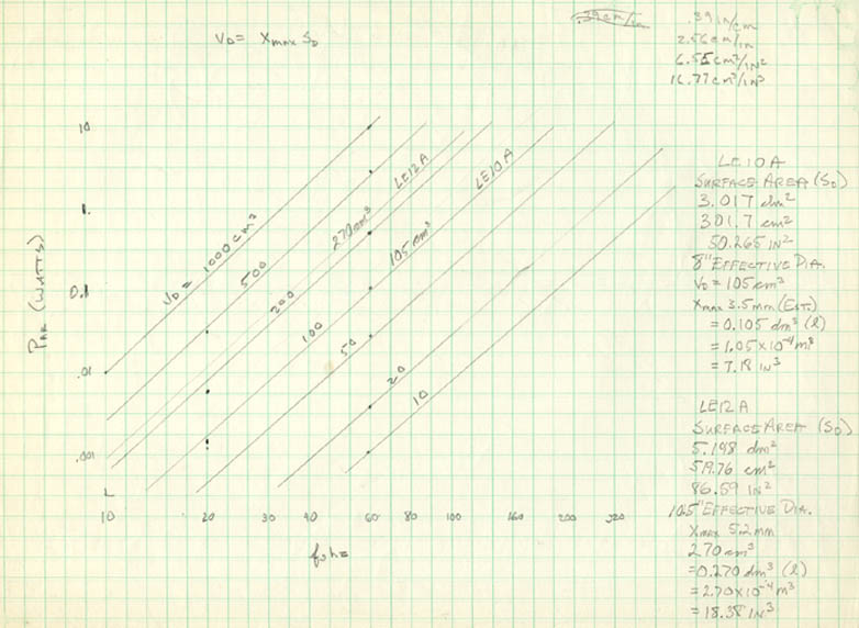

Nice primer. I thought I'd provide a practical application from my early experiences.
The graph below is a reproduction of Small's graph. Based on an article from Audio Mag., I set my goal to be able to produce 1 acoustic Watt (aW) (a bit ambitious, but doable). I had already purchased the JBL drivers, so my approach was backwards, but that's history. I had a JBL 124A, 12" woofer, and a LE10A, 10" mid-bass for each side. I extended the graph past 300Hz for the mid-bass. To the right are the results of my volume displacement calculations. I took those Vd values and created a line on the graph to represent the drivers maximum output capabilities. It shows that a single LE10A is max'ed out reproducing 1aW at just over 100Hz. the 124A was good down to about 65Hz.
Today I have 2 LE10A's per side, so their good to 75Hz. I have also replaced the 124A's with TAD 1601a's. These have a Vd of about 500cu.cm. In a stereo pair they max out at about 40Hz. As Kelticwizard indicated, these woofers get about 12db of help from the port.

Care should always be exercised when dealing on the theoretical level. There are typically assumptions made in the development of the theory being applied. You should be aware of these assumptions, and the ramifications if you do not know what the assumptions are.
One of these assumptions is that this graph is valid only in the bass region as Kelticwizard indicated. However, there are other reasons for this limitation then just the one that is indicated by Kelticwizard.
Small's graph has a second scale for SPL. But acoustic power and SPL are not a direct relationship. Outside of the bass region, you must take care in using this approximation.
Acoustic power is a measurement that is not dependent on directionality. The acoustic power generated by a speaker spreads throughout the listening area. In the bass region, this spread is omnidirectional. As the frequency being reproduced increases above about 100Hz (depending on the size or your room and placement of the speaker) the speaker starts to become diractional. It outputs the same amount of acoustic power, but that power becomes more focused. When this happens, the SPL associated with a given acoustic power level in the bass region, begans to increase while the output power stays the same. Once the driver is more then a quarter wavelength away from a room boundry, the relationship between acoustic power and SPL shown in Small's graph begins to change.
