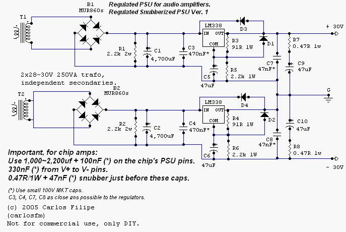

LM338 regulated snubberized PSU for audio amplifiers
Here it is.
Results are impressive, this elevates the chipamp to a league of it's own.😎
:att'n: Notice that I recommend 1,000~2,200uf caps on the chips, snubberized.:att'n:
I'm using 2,200uf.
This regulated PSU is good for two chips (LM3886, etc.).
As a side note, this is not only a PSU for chip amps.
There are discrete class-A amps around that use the LM338 regs.
These amps will also benefit from the snubber.
No, let me put it this way: every regulated PSU benefits from a snubber. 😉
The values for the snubber were calculated for the LM338's output impedance. Don't ask me how, I won't reveal it.
Enjoy.😎

You have a complete PSU schematic with the right values.
What do you want more?😕

If you pretend the power supply is a speaker and calculate a zobel for it, that gets you in the general ballpark. Mess around with the values a little to see what works best.
XELB said:
If you say that this one is much better, I will give it a try but I only have 8,600uF caps.
That's not important, those are fine.
On this PSU you should have around 10V more voltage before the regs, so there's plenty of voltage to sag.
After the regs, the voltage is steady as a rock, of course.😉
Big capacitance is not needed, 4,700uf is fine, or up to 10,000uf.
I don't feel like messing around, it's fine as it is.
Try it with these values.
Then you can try other values, but I doubt you can improve this...
I'm not saying the values aren't great as they are, I'm just saying that's how you can calculate the values. I don't know if you tried these values yet, but 1 ohm and .1 uf look like good values to correct the impedance issues above 1 mhz.
I'm lowering the impedance at a much lower frequency.
1R+100nf is what I recommended for the unregulated PSU, and it's fine for that.
That's cool, I'm not trying to say that you're wrong or anything. I'm just trying to say that you can calculate the snubber by calculating a zobel network based on the output impedance of a power supply.
Just letting people know how to calculate the snubber so they can do it on their own and experiment with values that their ears agree with.
